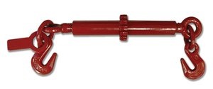

image.jpgimage.jpgimage.jpg. I have used these hauling heavy equipment before. You never need to worry about a handle rattling into a tight spot and getting stuck, that being said don't set the handle down to tie on your wide load signs and forget it, of course that is just a hypothetical scenario.

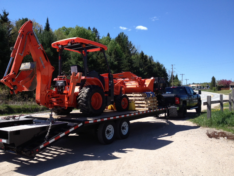

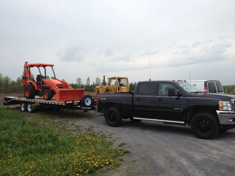

andre, You need to drop the hoe to the deck and secure it. Be careful tying down over your ramps, you might end up with a kink in the ramps over time or after a hard stop.

<img src="http://www.tractorbynet.com/forums/attachment.php?attachmentid=388060"/>
Here's how everyone does it around here 2 short chains in the front hook that up and back up till their tight then put your longer chains in the back and put your binder in the middle and wrap the extra chain around it to make sure it dosent pop open also when you close your leaver binder give it a good hit it will lock it
<img src="http://www.tractorbynet.com/forums/attachment.php?attachmentid=388061"/>
I would put two chains in the back vs one. Last thing I want is that tractor coming through my cab in a crash.
Chris
   / What size chain binders and chains? #17
andre, You need to drop the hoe to the deck and secure it. Be careful tying down over your ramps, you might end up with a kink in the ramps over time or after a hard stop.[/QUOTE
I stopped at our local scales (MTO) and ask they said I don't need to because theirs a way to lock it both up and side to side and I'm not to worried about the ramps bending they weigh about 400 pounds a piece
