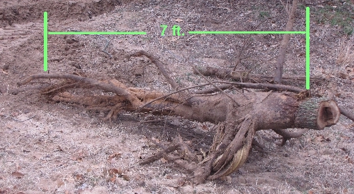

Make life easy and get a good 1/4" grade 70 short link chain. The 75 hp New Holland, with loaded tires and wheel weights, pulling this 6 inch dia. walnut stump is no match for a good 1/4 inch chain.

I am going to go the other way on this and say you need at least 3/8" G70 minimum for any pulling you might do.
The 3/8 you have currently is probabally grade 43, and is only a little stronger than the 5/16G70 chain. 5400WLL vs 4700WLL
But you have a big, heavy, and strong backhoe. I woundnt even fool with the 1/4 chain. And only use the 5/16 stuff for light work, like maybe lifting a mower deck off a trailer, etc.
Mut when it comes to pulling, MOST tractors are at least capable of drawbar pulling with a force at least equal to the machines weight. And your machine is 7000lbs:confused2: And with the weight distribution, it will probabally exceed that in a drawbar pull.
And if you ever hook the chain onto the BH to use its hydraulics to move things, you are capable of almost 6000lbs of force with the bucket.
I have a L3400, that only weighs ~3600 with FEL. And I use 3/8G70 chain because I dont like breaking chains. I have broke GOOD 5/16 G70 chain with just sheer pulling force. Pulling a log, chained to 3PH and 3PH raised up for max traction (weight on rears). NO jerking at all. Just a smooth pull and the chain let go.
Of course all of this is just my opinion. The 5/16 will work for most light stuff. Like just pulling a vehichle, light lifting, etc. But if you are going to be dragging logs, yanking stumps, etc, you can either get the 3/8 chain now, or later.
