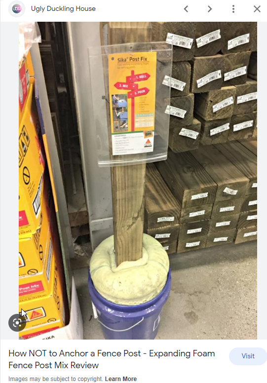

I've seen 3x the size online but nobody seems to do that in real life. What size bit would you use for a 4x4 post? I will use either concrete or the foam stuff, probably the foam, so maybe the hole should be smaller diameter?

expanding foam
   / What size earth auger bit do you use for a 4x4 fence post? #5
Yeah, polyurethane foam. Thats what I thought but I wanted to see what Learning2tractor responded with. That crap don't last since polyurethane breaks don't with moisture and UV and becomes brittle in about 2 years. Then someone taps your fence post and it falls over.
I'm a compacted soil or mixed concrete into the hole kind of guy. If I'm going to do the work, I will do it once NOT many times.

I use a 9" auger to put in standard split rail line posts (6"x3") and corner / end posts (4"x4"). For non tensioned fence types I only pack the soil, and don't use concrete. I would not use a foam product on a permanent fence of any type.

For the past five years local utility is using foam when setting poles. They are not having poles fall over
   / What size earth auger bit do you use for a 4x4 fence post? #8
Streetcar,
Several huge differences in what the power company is probably using for urethane foam and what guys walking into the local hardware are going to be able to purchase. I spent 20+ years in advanced elastomers and there are many grades of urethane for many different applications. I could bore ( pun intended ) your with the details but finished cured urethane can range from glass like to foamy elastic stretchy sponge just by changing the polymerization components/ ratios.
Power company is also sinking that power pole a min of 10 feet and probably closer to 15-18 feet into the ground and they are probably using a very small overbore tolerance which all produces a tight fit and very little foam gets used.
