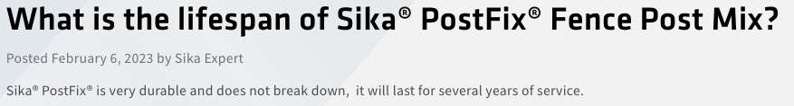

Streetcar,
Sika's web site provides the following guidance on lifespan.
The "it will last for several years of service" response it not something I find acceptable. "Several" is a number greater than 2 or 3 but not many.
When I take the time to put a post into the ground, I expect it to last decades of years. I suspect ctgoldwing, when he planted a 100+ posts into the ground wanted those posts to stay firmly in place more than "several years" and in fact are still in place after 15 years.
Now if one wants to purchase the commercial grade utility pole setting product from then I might consider running a trial of the foam on a few posts to monitor its performance. Sika does not appear to sell a commercial line of foams for setting utility poles.
