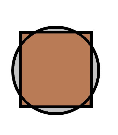

Hmmmm, I'll turn that question around on you. How would you determine the minimum radious of a hole required to fit a square 4x4 into?
I wasn't suggesting you were wrong, but personally, I just pull out a measuring stick/tape, make a rough guess at corner to corner width, add 1/2-1" to each side of that value, pick the size auger closest to it that I have and call it a day. I don't normally have a calculator with me while I'm working - and no cell signal, so I don't carry phone. 2-way radio doesn't have apps like Calc either - actually it doesn't have any apps now that I think about it. 🙃😉😁
   / What size earth auger bit do you use for a 4x4 fence post? #72
How do you find the diagonal measurement?
If you are sinking posts, measure from either end. It's not like the post is already in the ground.
   / What size earth auger bit do you use for a 4x4 fence post? #73
I didn’t have a 4x4 handy but was at a computer 🤣
