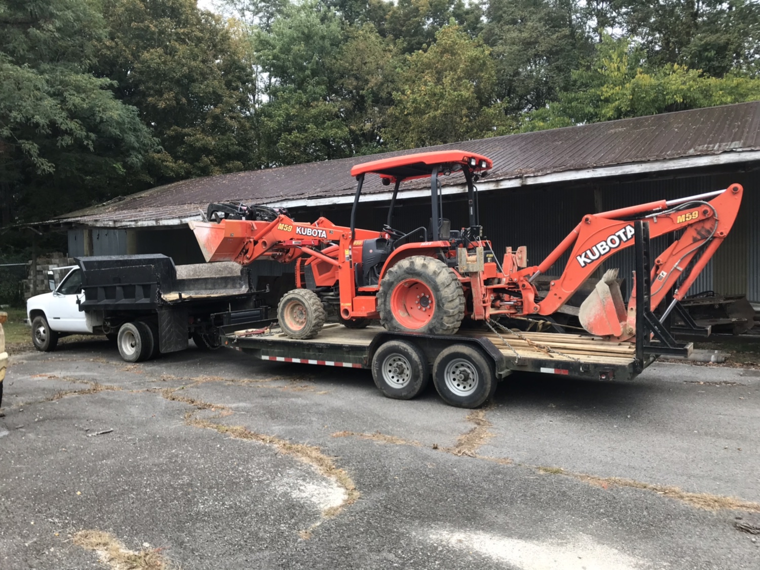

I have a 20k trailer but I move my M59 on my 14k trailer close to weekly. The spec weight is 8300 and the tires are loaded that probably adds a ton. In that picture I was also carrying the grapple. My 20k trailer weighs 2500 pounds more than my 14k and its a deckover with steeper ramps. The 14k is all around a more pleasant experience when more capacity isn’t needed. IMG_9144.JPG

Do you tow with grapple in bucket, and bucket raised, as in photo?
I’ve since started putting the bucket on the deck but yea I’ve moved it a few times with the bucket in the air. The M59 rides back heavy and I wasn’t satisfied with the weight distribution with the bucket on the deck. It’s well under legal height, really the worst that could happen is it falls and damages the jack. I probably should’ve strapped the grapple but it’s well situated. Nothing short of a rollover would dislodge it.
