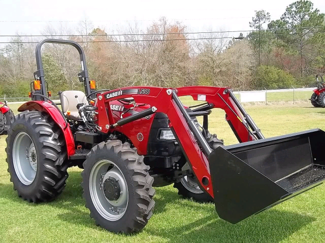

Hi everyone! Im looking to get a grapple! What size would all of you suggest? Its going on a case ih 55a. And what brand would you recommend for a tractor this size?

It's about what you can lift that will determine the size. I bought a grapple for my Kubota and realized it was too heavy by the time I lifted anything. I know I should have checked teh lifting capacity and the weight of the grapple.....but I just went by SIZE, huge mistake.
HP has nothing to do with you loader lifting capacity.
I ended up keeping the grapple and getting rid of the Kubota that could lift 1,500 ( with the grapple about 500 pounds ) pounds to a skid steer that can lift about 7,000 pounds - with the grapple not even a issue.

We can't give you a good answer unless we know what your main uses will be for the grapple. In some cases anything over a 48" is more than you need, and in some you should go with a wider grapple, very rarely do you need one that is as wide as your tractor. There are also pros and cons between grapples with 1 grapple arm, or 2, there are root rake grapples, and flat, open bottomed grapples. Most of the time the flat open bottom grapples are more useful than the root rake (clamshell) type.
Can you give us more info on what you will be doing with it?
/ what size grapple??
I will be using it to pick up trees and alot of brush and hopefully dig up smaller roots with it I have a little over 15 acres im trying to clear and thin out around my lakes!

I've got a 48" grapple and really can't say that a wider one would've any more help. I usually am moving trees, brush that I cut down (and occasional large rock). Wider would cause me to clip a tree at times as I work my way into the trees.

The bigger and heavier the grapple is, the less you can pick up. On my 55 hp LS, I'm most pleased with my WildKat 48" econo grapple. I can pick up everything I need to, which includes whole large trees. Call them for the best price. Review the prior threads re grapples.

As bad of a way to rate what size (not width) grapple would be correct most mfgs seam to use HP. I think I would avoid anything that's not rated for nothing less than 40ish hp. I don't know if you'll get as much life out of it before having to repair it if you end up with a grapple that's designed to be used on a 2500lb 25hp cut. It's no different than getting a grapple made for a large 15000 lb tractor. You need to find the sweet spot for your tractor.

There are advantages to two grapple arms with the main disadvantage being weight. bottom line is you can do everything with a 48" grapple that you can do with a wider grapple. The only difference is you can typically do more, faster with a wider grapple and 2 grapple arms. The times where the extra weight and wider size can be a disadvantage, are when you are right at the limit of your lift capacity, and when you are digging with the grapple. You will be able to dig better with a narrow grapple, due to the fact that you are applying more force to each tooth that is digging.
I have a 64" WR Long grapple and wouldn't trade it for the world. I am more than happy with the product and customer service. There has been a lot of talk about Wildkat lately so certainly check them out. Be sure to check the weights. Mine is right around 500lbs, I want to say 485 from memory but I have a bad memory :D
I was clearing some land a couple weeks ago and long story short, I got more done, faster with my wider 2 arm grapple. I was able to knock several trees down, cut the stumps off (after ripping them out of the ground) and I could then carry 2 stumps per trip with one stump in each arm. These were smaller stumps from about 12"dbh trees. It cut my trips in half and when your carrying them a good distance this makes a difference.
For the larger stumps, you can only carry one at a time anyways, just like with a smaller grapple. Many people tried to talk me into the 48" grapple but I'm glad I went with the larger one, having said that, I have to agree that a 48" one armed grapple can do everything a 64" two armed grapple can do, I just think I save time with the larger one, mostly because I do a lot of tree clearing/stump moving, and a lot of firewood work. With my 64" flat open bottomed grapple, i can stack a lot more wood on there than the 48" would allow. It really depends on your uses. Since you mentioned digging, I would lean towards the narrowing grapple.
As far as clam shell vs. open bottom like the one in the pic you posted, I would go with the open bottom. I've used both of them and much prefer the style I went with, the OBG 2 from WR Long (or similar)
