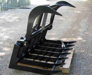

Your grapple should be no wider then your front tires. This is good sound advice on compact tractors. Keep it light but strong.
Check out Ambo grapples they are a little more expensive but are the caddy of grapples. Super lite and super strong.

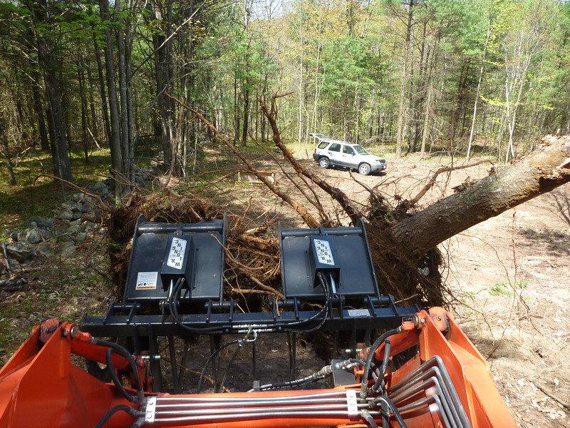

Rockgod and Piston, thanks for the encouragement on the grapple I purchased. I know in a few weeks, I will have a better feel for how this new implement performs. I've moved 85 Cu Yards of rock so far with the bucket. Now comes the Boulders. 3-4 of the boulders are very large, so I may end up skidding some in close to where I need them, then giving them a little curl/push with the bucket. Also, with this new equipment, the two piles of logs and brush, that have taken about 1/2 an acre away from my planted field can be moved quickly, after I cut the log sizes down.
I did have my dealer install the 3rd function kit. I just do not have the time, with work, and the projects that need to be finished. It was not cheap, but the work looks very good. (I'll post some pics of their work) Thanks again for you guys on this forum. I originally only had a drawbar and clevis between my 3pt arms, to claim as my implements. This forum helped me correctly choose those implements I now own, which have increased my ability to finish projects faster, correctly, and safer.
/ what size grapple?? #31
One thing I want to mention about log handling with the grapple...
Sometimes if the log is too heavy for my FEL to lift, I will drag the log with the grapple, by driving up to the end of it, squeezing down on the log, and backing up to where I want to go. In fact, sometimes I can do two logs at a time with this method.
However, if you do this, be sure to be extra careful when turning, I only back up in a straight line, or a very wide radius turn. If you turn much at all, you are putting tremendous forces on the grapple arms (torquing force) with the long lever arm the log creates, and will bend the grapple arm. I bent part of my grapple arm (the outer tooth on one grapple, and actually it was my dad not me:laughing:) but it was easily heated and bent back.
Just something to keep in mind.
You will be absolutely amazed at how much work you can do with that setup. I brought my bucket with me when I cleared some land last month, hoping to try out my brand new ratchet rake, but I never once took the grapple off. This is as close to work as the ratchet rake has seen, it made the trip up, and back down, but never got hooked up to the tractor. :laughing:
