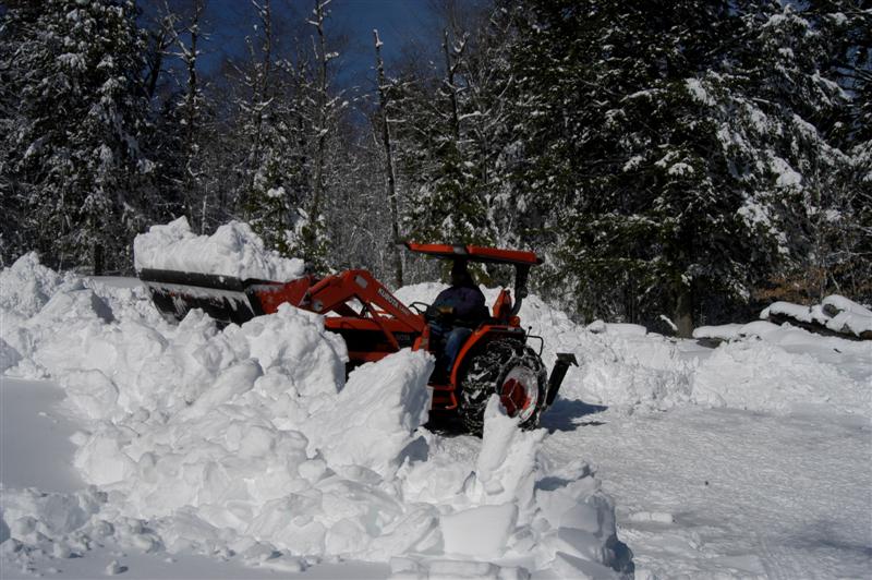

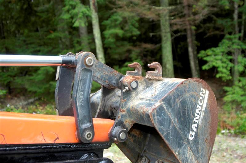

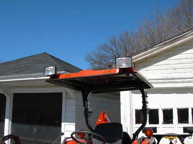

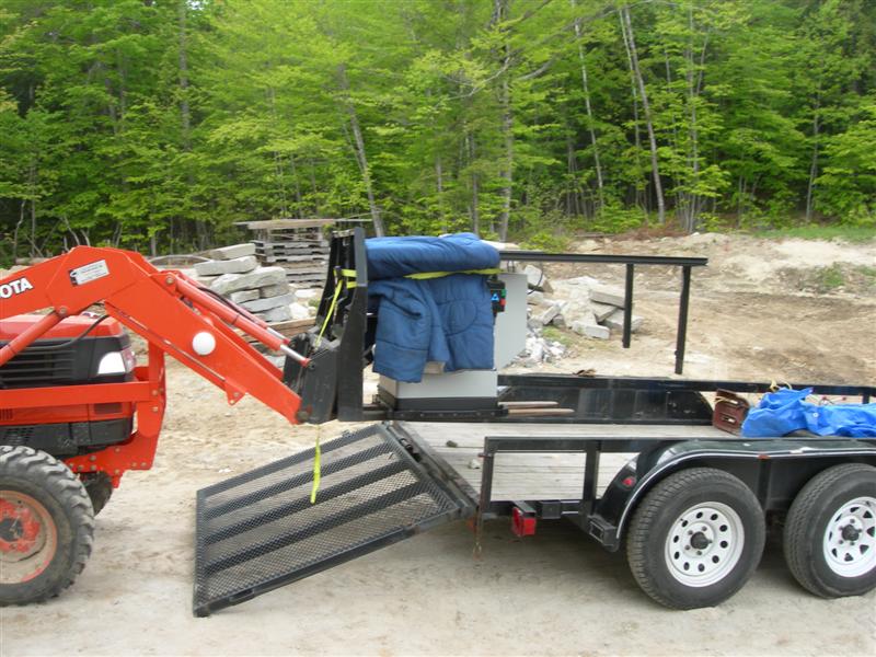

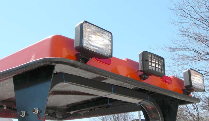

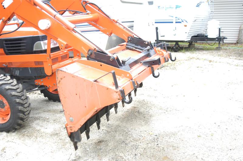

When I bought mine ( '02 L3710 ) I purchased the ATI quick disconnect and forks. It added $700 to the price and it's been such a help it was worth 3 times that. I also bought a canopy, I enjoy being outdoors even in winter, this also made extra lights easy to install. Useful placement of hooks on the buckets and good lighting. Most of which I found by searching this site.
I spent many hours on this site before I bought and have never regreted what I learned
