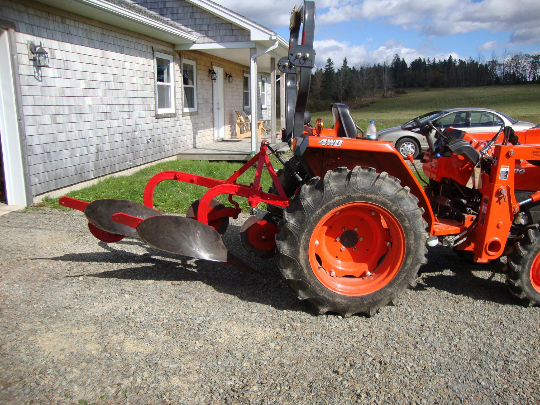

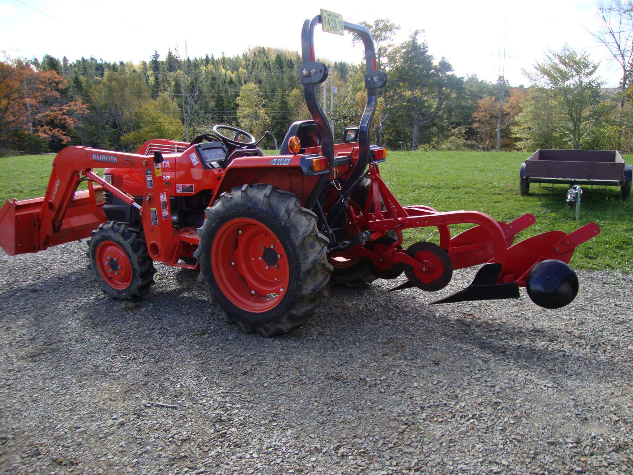

I've the two tractors in my sig, a Kubota B7610 (24HP)and a Kubota M4700 (51HP) both 4WD, and I'm planning on separating them by about 800 to 1,000 miles, but still share implements among them. I think it will be a lot more energy efficient (cheaper) to carry a plow, harrow and pallet forks in the back of my truck vs dragging my trailer all the time. Primary usage will be small vegetable gardens and deer plots, no plans to do acres and acres. I figure with the B7610 I'll have to plow shallow once, then plow a second time deeper.
So I've a few questions on plows -
Is the only downside to using a 1 bottom plow on the bigger tractor the time it takes to do the job?
How important are coulters?
What about gauge wheels?
I don't think you are going to find a plow that will work properly on both tractors. I have a 2x14 bottom plow that I use on my Ford NAA and 5203 Deere, and it barely clears the ground on the B3200 in the fully raised position. The B3200 is just way to small and the 3pt geometry isn't right for it. For a compact B-series you need something like a small 1 bottom 12" plow with a compact frame. Likewise, this wouldn't fit the geometry of your M-series, plow would be too narrow and you couldn't get your tire in the furrow.
