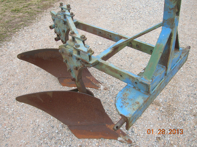

/ What size plow
How do you think this would handle?

Leonz: a single 12 is ridiculous for a 50hp tractor, c'mon! I pull a single 16 with 26hp. Give the guy some decent advice.
A two bottom plow on an mx5100 would be great. I believe a few guys pull 3 bottoms with that tractor, but in my opinion, it doesn't have the weight behind it for that. A two bottom with 14" moldboards would be my #1 choice. Don't know your soil type, but this should enable you to move along easy and quick enough to do a fine job of actually turning the soil over. Lots of guys say they can 'pull' a bigger plow, but in reality they aren't pulling it fast enough to do a proper job.
That picture looks light you're on the right track.
/ What size plow #6
Your tractor would handle that plow just fine. I use one almost identical to that one, and my tractor is much smaller than yours, 34 hp. By the way, that is a very nice plow, Ford 101 I think. It is trip plow, not a shear pin version, very handy.

I didn't know plow tripped?

tripping plow...
it is an over center device, or a spring loaded device that holds the plow in place. It you hit something buried in the ground, the plow will trip out before damaging something. You generally set the plow on the ground and back up to reset it. A shear bolt plow has a bolt that hold the shank in place. Hit something, the bolt breaks and releases the bottom before something is damaged. You push it back in place, (or hammer it) replace the bolt and you are on your merry way. There are several different methods to the same end but they are all to prevent damage.
PS looks like the hitch has be replaced on the plow you pictured. I'd look for another plow. That hitch is welded solid. A correct hitch is adjustable and allows you to adjust the way the plow trails the tractor. Very important. A well adjusted plow pulls easier.

Also, I agree with you 100% about the hitch being replaced on the plow in that picture. That was the first thing I noticed. The 'back half' looks to be a Ford 101. Great plow, parts are cheap and readily available. You could never set that plow up properly though with the hitch being welded solid. I always make little adjustments to mine while I'm plowing to get it to run just right. Especially at the beginning. That's part of the fun of plowing!!
