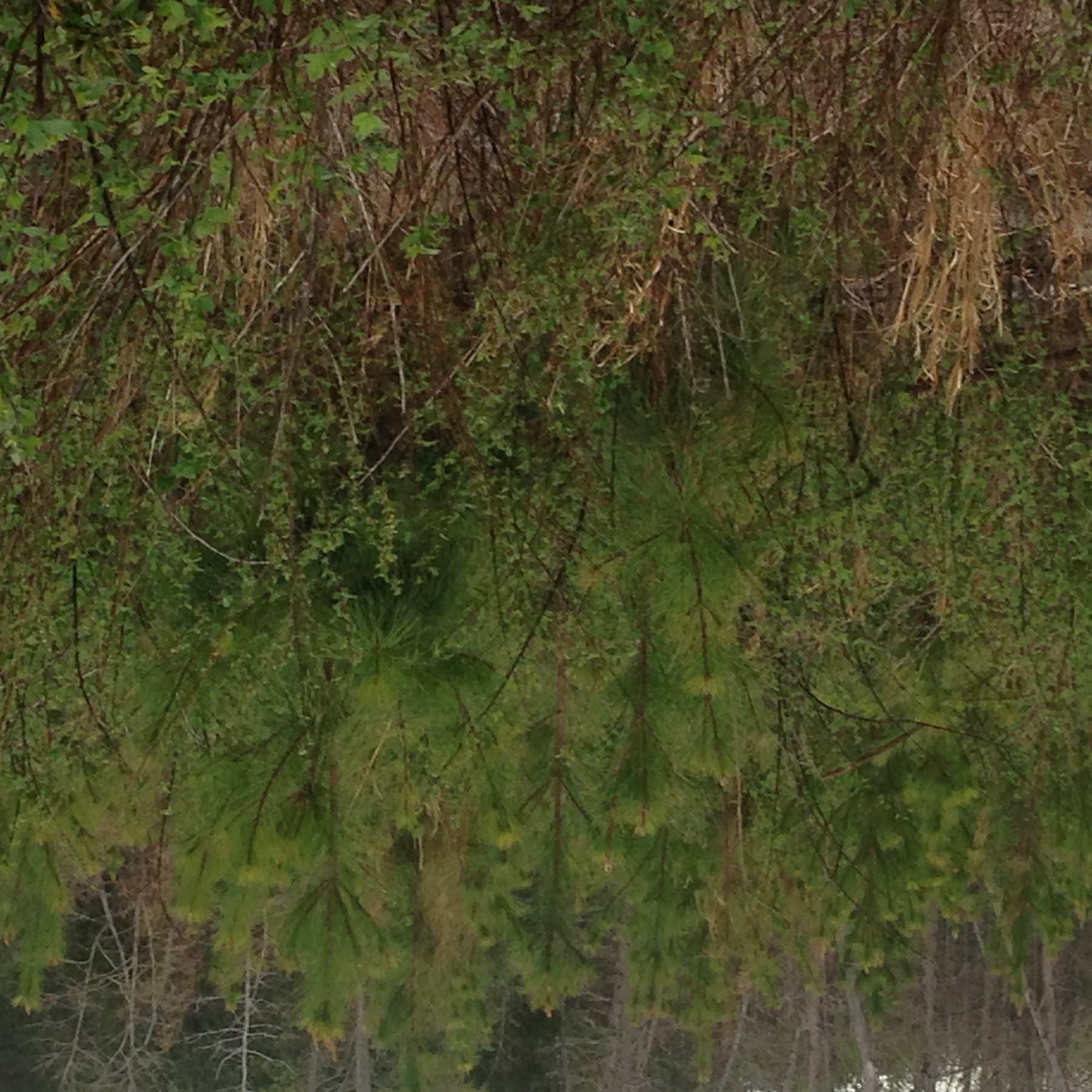

I went down to my property and took some pictures to give everybody an idea of what I am going to be clearing. I will be using my grapple bucket with the bush hog. I am going to pile up all the dead stuff and burn it.

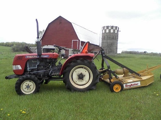

I cut 8' high brush with a 15hp Shibaura and a 4' Kingkutter (1-2" Diameter)
Moved up to a 5' Kingkutter on a 24hp John Deere
My 40hp New Holland is 66" wide. I am now looking for a 6' rotary cutter.
You will have plenty of power for a 6 footer.
