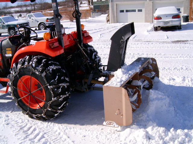

Have you ever checked into a used snow blower ?
I decided to look for used snow blowers this year.
I didn't look long and came across this 63" dual stage blower for $800.
Very good condition and works great.

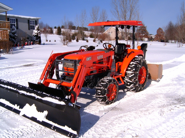

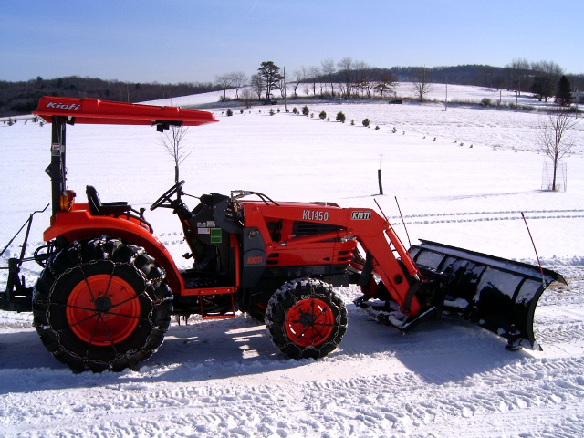

- A straight power angle plow will be too far out front for the wheel base
Sorry, I'm still not really answering your bucket question.
But when running my straight power angle blade front blade (converted 9' Western truck plow) in the straight position I don't think my wheel base is any/much longer than with the bucket.
I kept my front blade as far back as I could to weld the SSQA plate on. The blades angle cylinders run underneath the front of the loader arms.
I think I have around $500 in my converted truck plow front blade setup.

My cousin has a 9' power angle truck plow sitting in the field that he offered to give me. He owns a metal shop and would help me convert it to a quick attach plate. However, I'm not new at this game. I've used angle plows on loader arms before and have always found the result unsatisfactory.
1) tractor walks sideways far to soon because the wheel base is short and the distance from the front wheels to the angled blade is long.
2) There seems to be a lot of concern about bending loader arms with this set up. Although I never bent a loader.
That being said, I like your set up DK35vince. Maybe I could get the blade back far enough if I mounted it the way that you did. Do you get heavy snow where you are and if so how deep can you run with the blade angled and still steer?

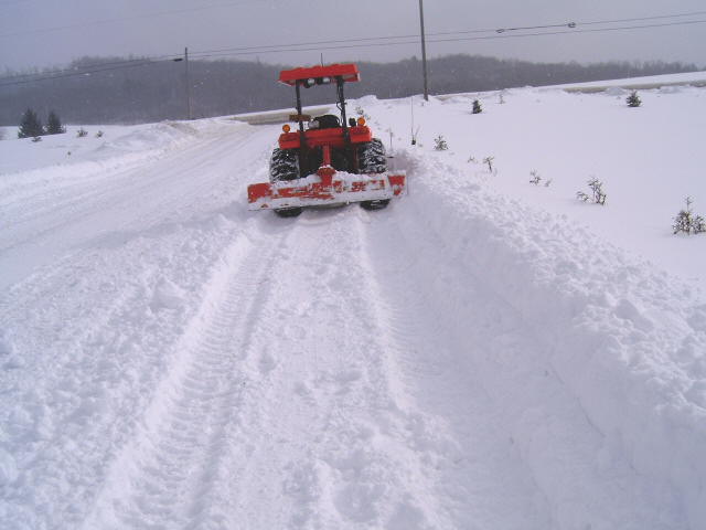

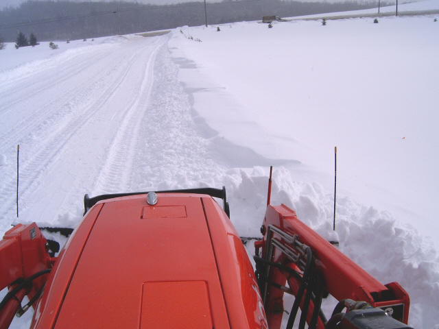

That being said, I like your set up DK35vince. Maybe I could get the blade back far enough if I mounted it the way that you did. Do you get heavy snow where you are and if so how deep can you run with the blade angled and still steer?.
In my area of Pa. I think we average around 60 inches per year snowfall.
Most of our snowfalls are under a foot, but we do get the occasional 1' to 1 1/2' snowfall.
If I don't put a lot of weight on the blade (just set the blade down lightly, do not float the FEL) I rarely have any problem steering. I run chains on all 4.
I can get drifting here and push back the snow backs with the blade angled with no problems.
