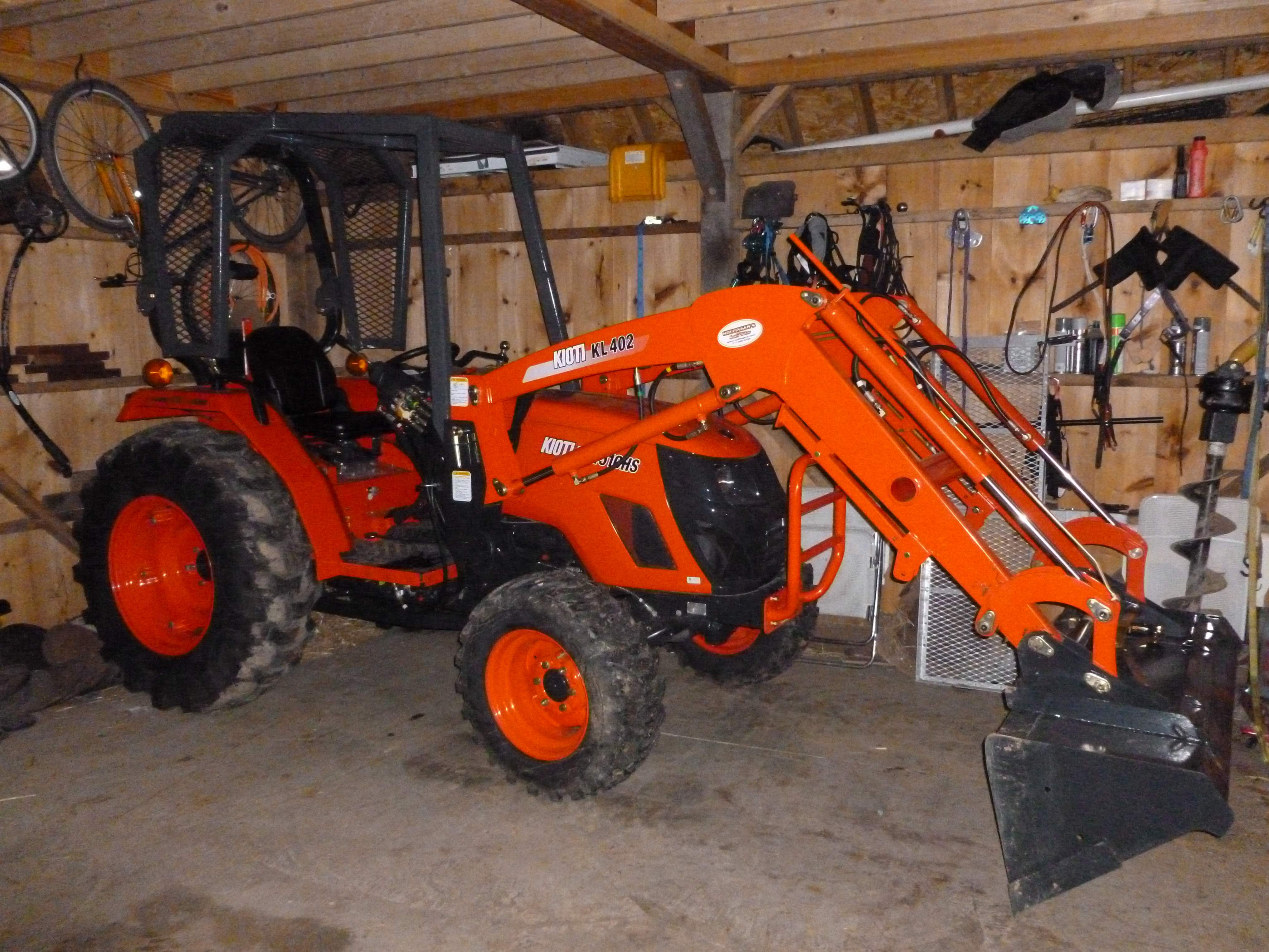

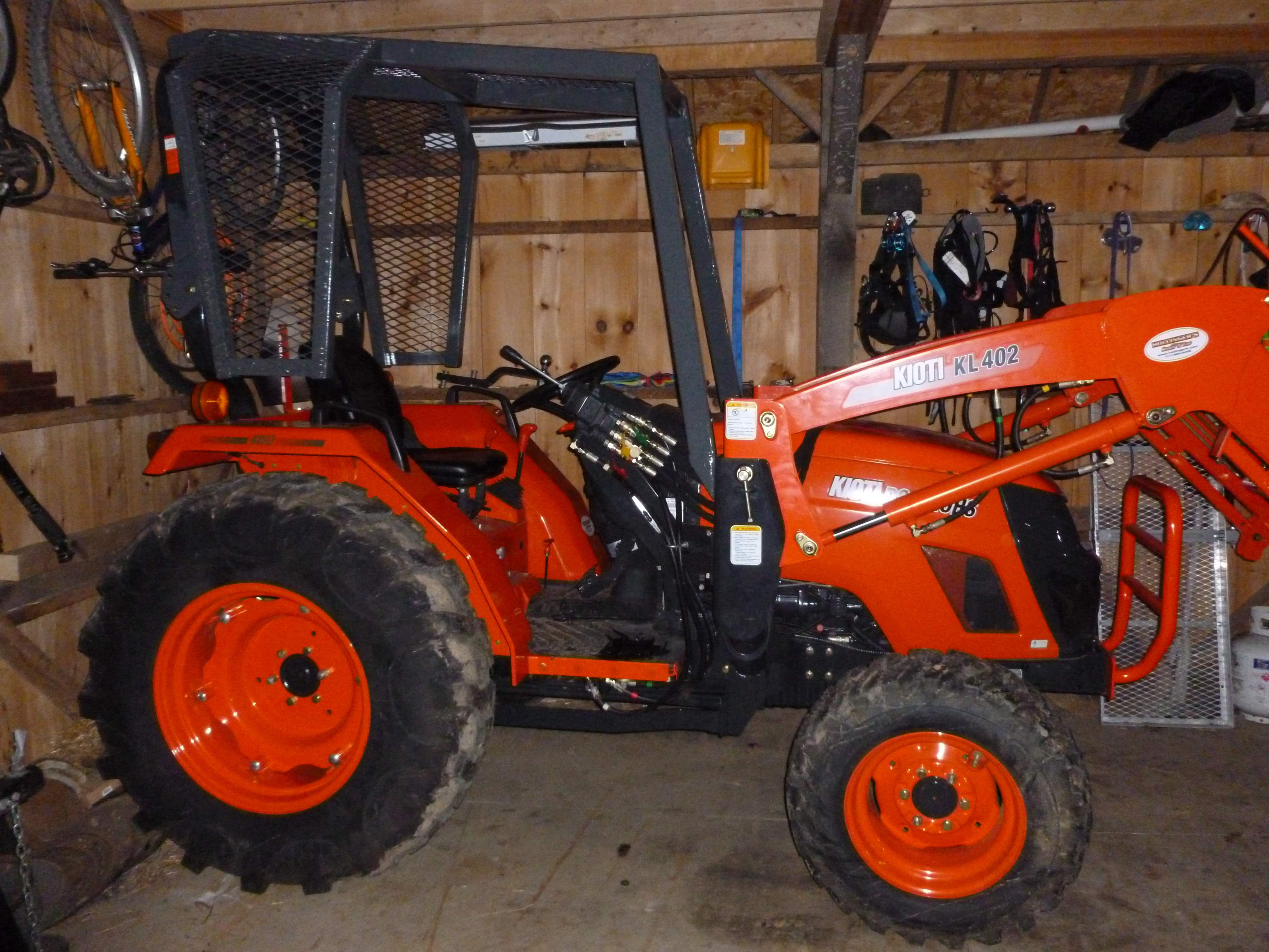

I believe the poster is referring to the "cage" around your tractor as pictured in your avatar. It is nice. Did you make this yourself?
I liked that cage. It was great in the woods because stuff would just ride up the two front rails and over the top. The small size of the tractor helped. On the flip side, that tractors lift limitations were a negative in the woods when moving trees around. It was made by Precission Chassis in Limerick PA. They typically build frames and cages for drag race cars.
I cut that cage appart and my cousin's metal shop welded it up to fit the DS4510HS. I couldn't run the main frame over the hood because it is a very wide tilt up hood compared the the LB1914 which was all panels that come off individually. Here's a picture with the same cage on the DS4510HS.

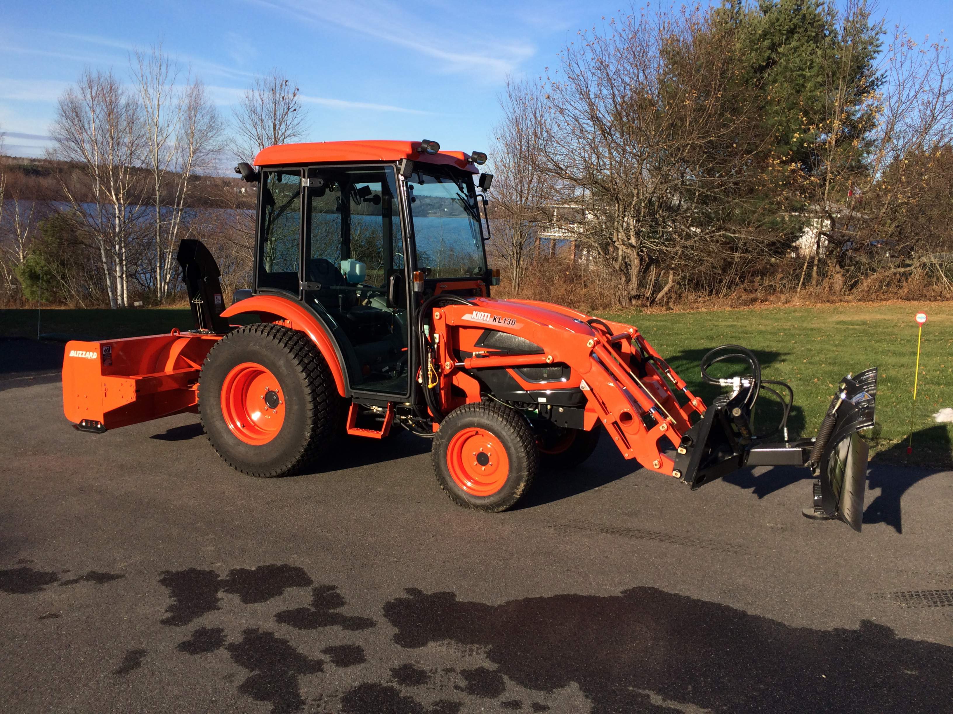

Hey Glade, I think you'll be fine with either the 84 or the 78 inch bucket. I'm thinking a load would have to be very heavy and completely on one side to bend the loader frame. Even then I'm not sure it would?? I'm not an engineer, that's just my gut feel from 30 + years of running small tractors.
I will put in a plug for a front blade. Until this year I have Always used the bucket and Blower to move snow. I put a blade on the front this year and all I can say is why did it take me so long to figure this out!! I doubt I'll even put the Bucket on this year at all. Yes the blade is out front a long way...But I get NO front push at all, even in a foot of heavy wet snow. 001.jpg
