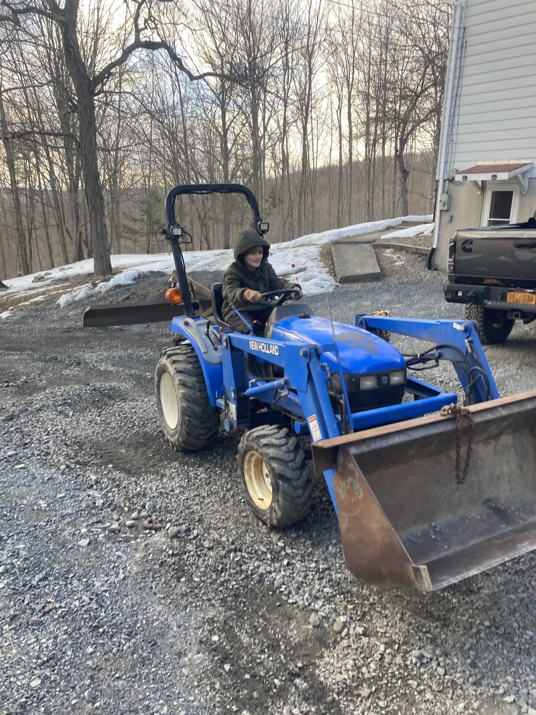

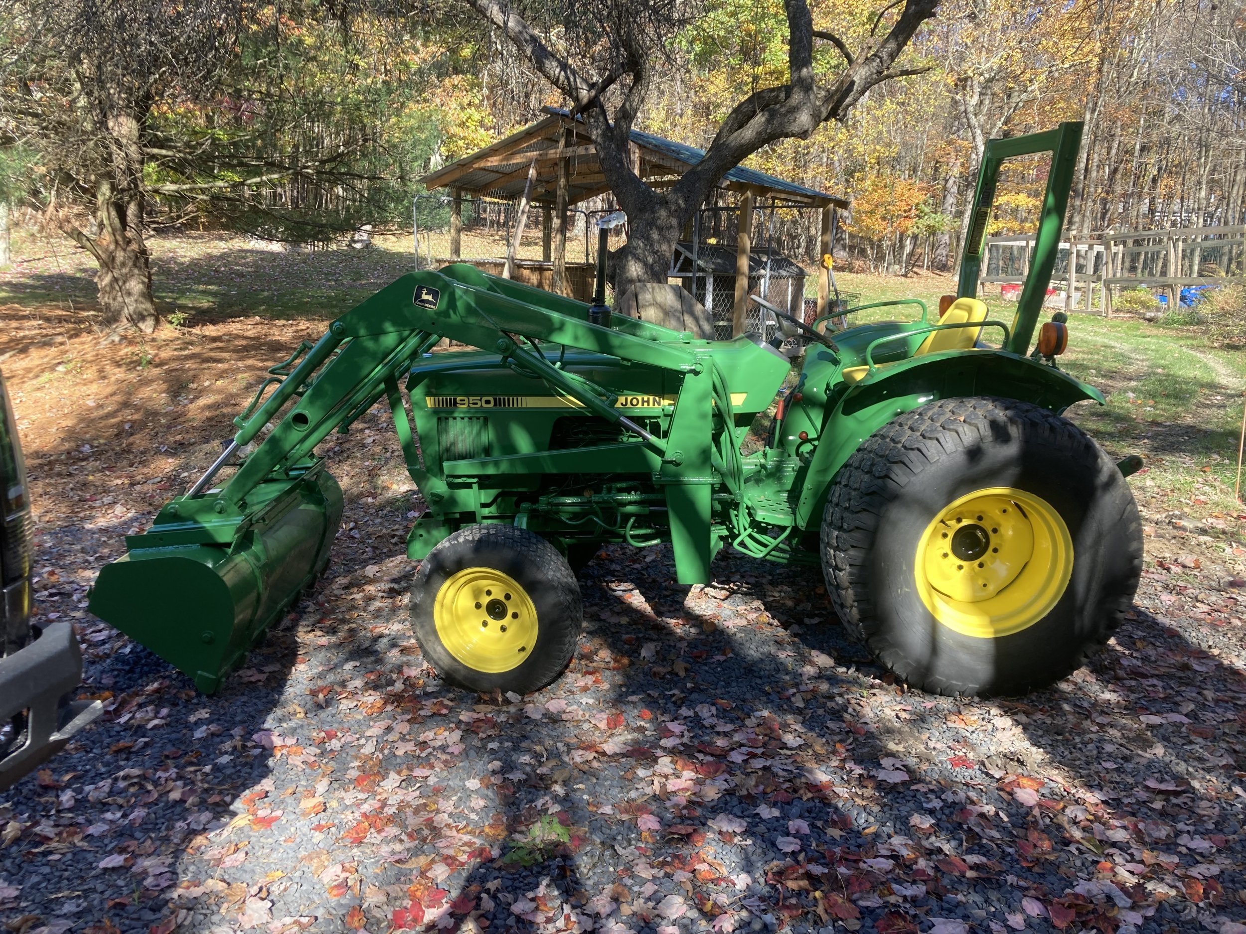

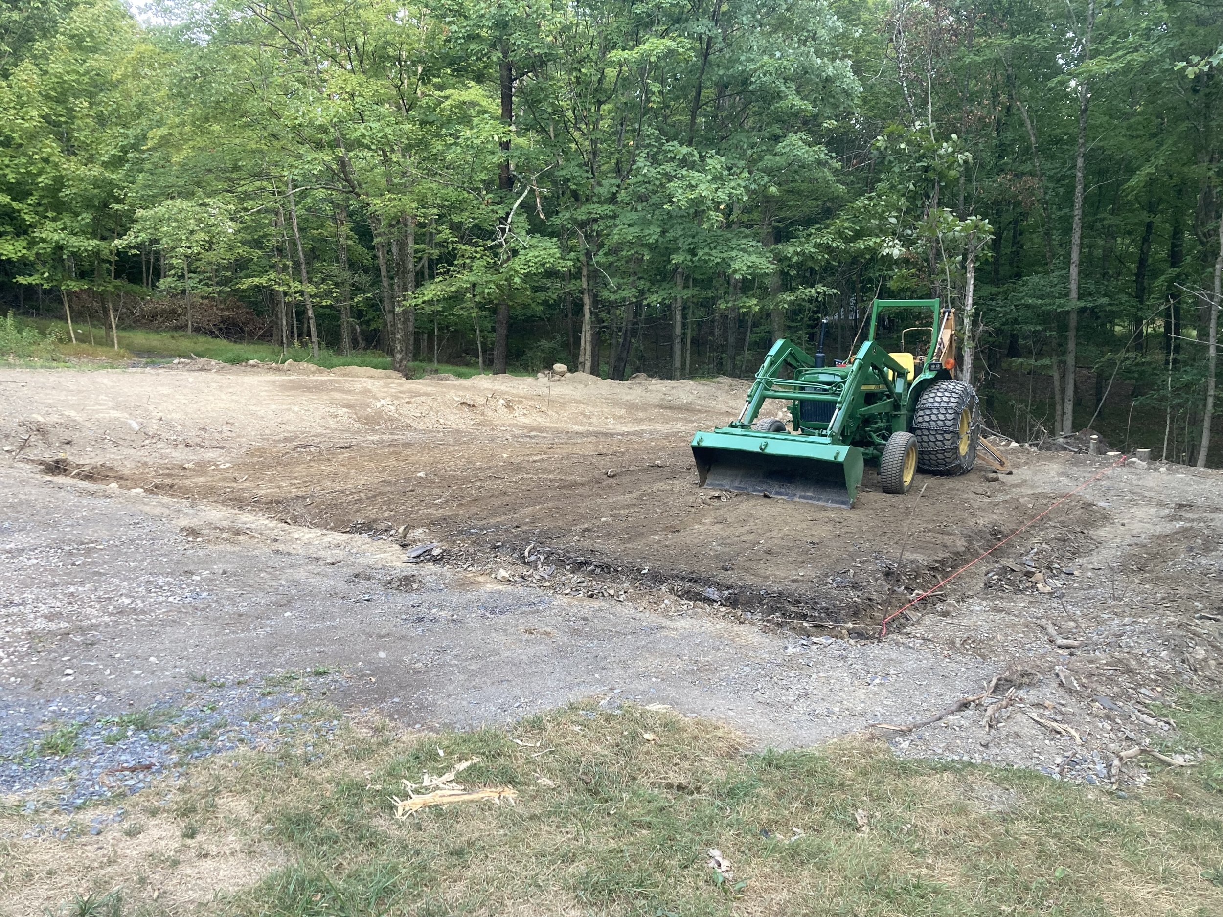

I went from a Hydrostat 18hp New Holland that was getting burned out mowing hills (I would have to stop mid mow and let it sit an hour) to a gear drive 31hp John Deere and I couldn't of been happier with the upgrade. Not to big/small. Handles snow, stone/grading driveway, backhoe, mowing and never gets tired.
