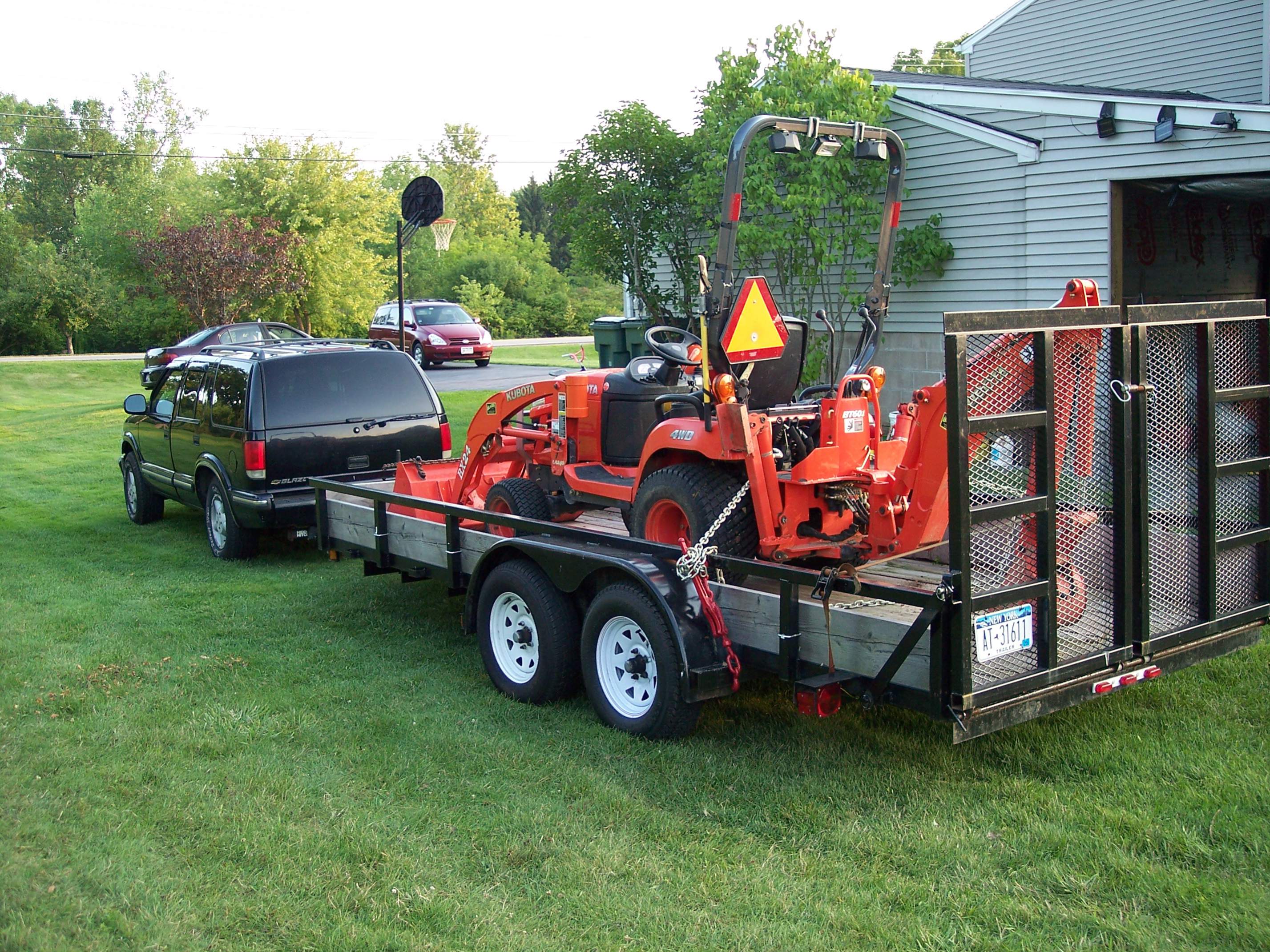

150 miles, most on Thruway.....heck, that s10 bombed around 10 miles in town no problem at 60mph with that 4' or 5' x 10' with no brakes...?
A utility trailer on an S-10 is certainly no issue...You might be able to find a 12-14' tandem with brakes that you could get away with using an assumed 4.3, correctly geared S-10..I wouldn't go bigger than that with any kind of load..Trailer brakes are a must in my humble opinion...

I believe my 91 4.3l S10 long bed was tow rated 5,000 lbs.
I used it to tow my Samurai and the BX with a 3500 pound GVW trailer that weighed 900 lbs empty.
The truck had plenty of power with the 4.3 and stopping with the trailer's surge brakes was not an issue.
The only place I felt the S10 came up short is it was light in the rear.... I did add some sacks of concrete to the bed and I noticed it handled better when towing.

The sticker on the door says GVWR-5150lb.?
This has nothing to do with tow ratings per say. GVWR is "gross vehicle wheel rating" That simply means the max amount of weight that can be on the vehicles wheels. Lets say for example your truck weighs 4,000# with fuel in it and you are 200# plus you carry around 150# of junk in the bed. That would mean you now have 800# of payload capacity. Payload is anything on the trucks wheels like additional stuff in the bed, extra passengers, tongue weight of a trailer, ect.
What you need to find out is the the GCWR "gross combined wheel rating" This is rating is the max weight on the wheels of both the truck and trailer. Lets say its 9,000# for example. Now you simply subtract the weigh of the truck loaded from that and it will tell you the tow rating. This is only in the owners manual, not on a door sticker.
If you give me the year, engine, tranny type, rear axle ration, bed length, cab style I can look it up for you. I am a part time trailer dealer and have access to all this info for most stuff built in the last 15 or so years.
As for a trailer a tandem axle is probably going to weigh too much and kill your payload on the trailer. A single axle trailer with a 3,500# axle and brakes on that one axle is going to weigh about 800# so it will have a honest 2,200# tow rating. This will probably be the best you can do. I think 2,500# plus the weight of the trailer is going to be a bit much for a S-10 because you are going to be pushing the 5,000# mark by the time you add in the empty weight of the trailer.
You really need a 1/2 ton truck for this.
Chris
   / what size trailer for 2000-2500lb.load? #19
Measure out that Uhaul trailer before trying it. They are set up to tow cars and do not have solid deck, hollow in the center. I am guessing your tractor is not wide enough to fit in the Gutters designed for the tires. I know a guy who tried this with a John Deere tractor bigger than yours and it was still too narrow to work.

I stopped by today to do it by the book but unfortunately the kid working there wasn't that type of person? "s10, sure no problem" haha, he didn't check anything even engine, maybe they do that at right up.
The trailer is 6x12 with a full size bed which appears to be made of a lighter steel than a reg.truck bed? Has the super dooper brake setup at the tonque. 2 days if P/U Fri. just before close & "on the lot" when they open Mon.morn so that don't seem bad.
