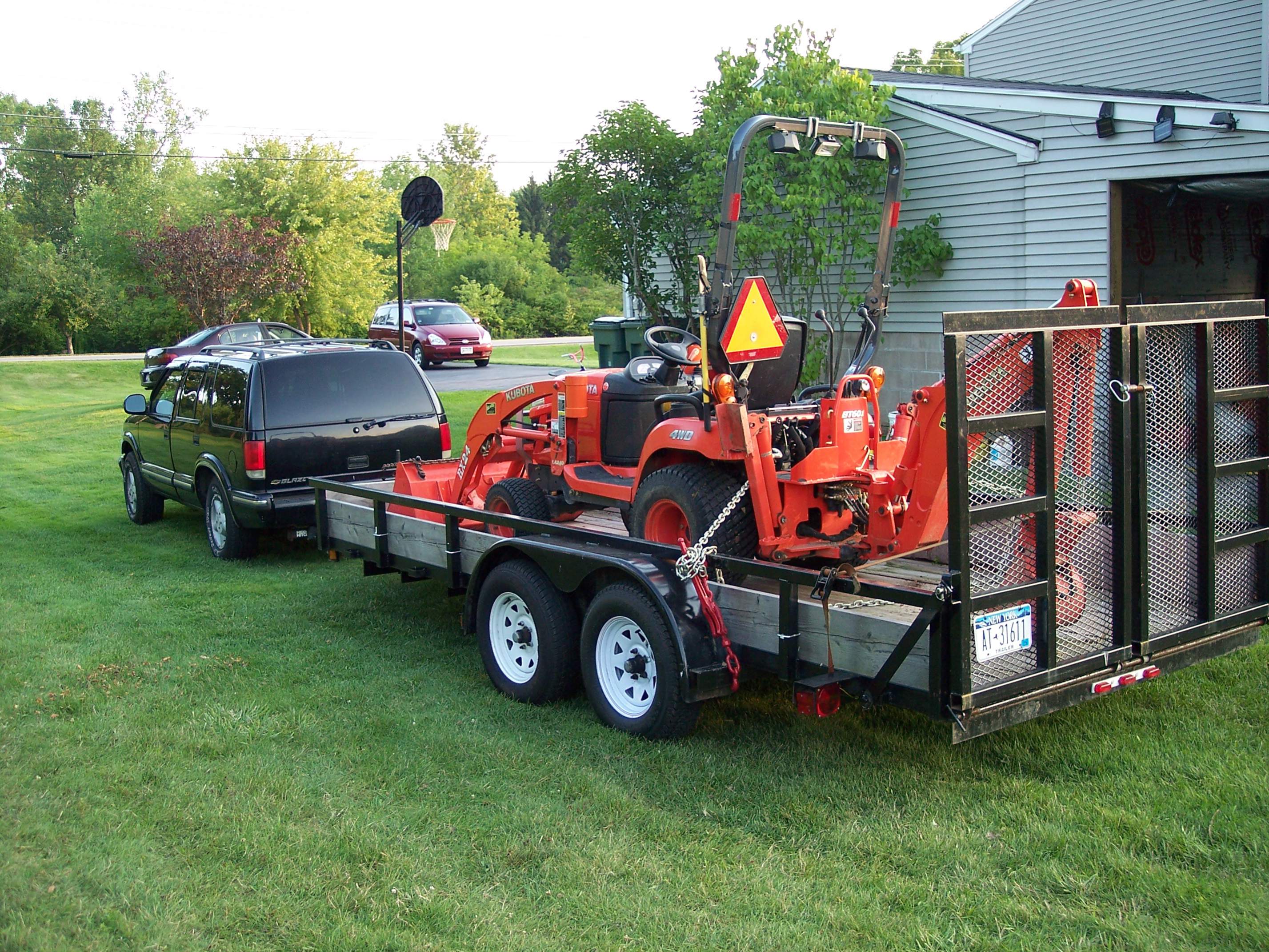

thats a little tractor, on a little trailer. my toyota tacoma 4 cylinder is rated to tow 3500lbs, and would have no problem with that trailer/tractor as pictured. i dont think he really needs a tandem axle trailer to tow an oversized lawn mower, and although a nice gesture, using someone's f250 or renting a uhaul truck seems a bit extreme. its no wonder everyone and their brother owns a f350 power stroke dually for weekend chores these days:confused2:

chris is making a point here. I have to constantly think about what I am putting in with my blazer AND 16' trailer because when I go over weight limit of truck but not trailer, I do notice the extra weight. This is where I feel the extra trailer parts come into play here. Like sway bar, WD bars and BOTH axle brakes( you probably know this but a tandem trailer in NYS needs both axles with brakes to be able to register it for use over 3500lbs. I am NOT saying you CAN'T do it with s10 pickup, but you are right on the edge of "legal" towing and it can be interpreted in thousand different ways if you get pulled over, just like me. I never had any issues with my setup.
