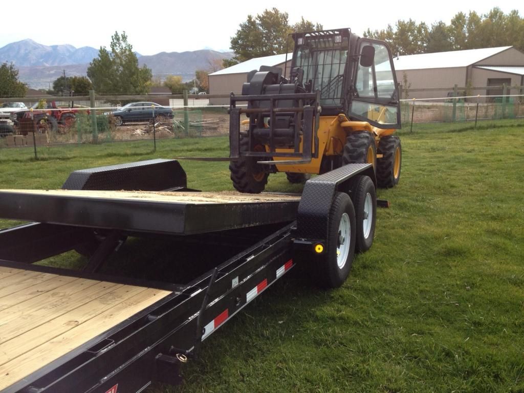

Here are a couple of picts from yesterday. The loading angle is really quite low.

I like the load angle. Is the trailer power up and down?

No, it just works off from a hydraulic valve that has a small control switch on the side of the trailer. I figured a power up and down would be a slower process. This way, I open the valve and stand on the end of the trailer and it's down in about 2 or 3 seconds. Slightly close the valve and the equipment will slowly pressure the ram back down with no slamming. Works pretty slick. I also just mounted a tongue toolbox for my binders and chains. Ready, Set, Haul...

It sounds like a nice setup. You won't have to worry about a battery either. Also you are supposed to check the wheels on your new trailer after 25 or 50 miles of towing to make sure they are tight.
