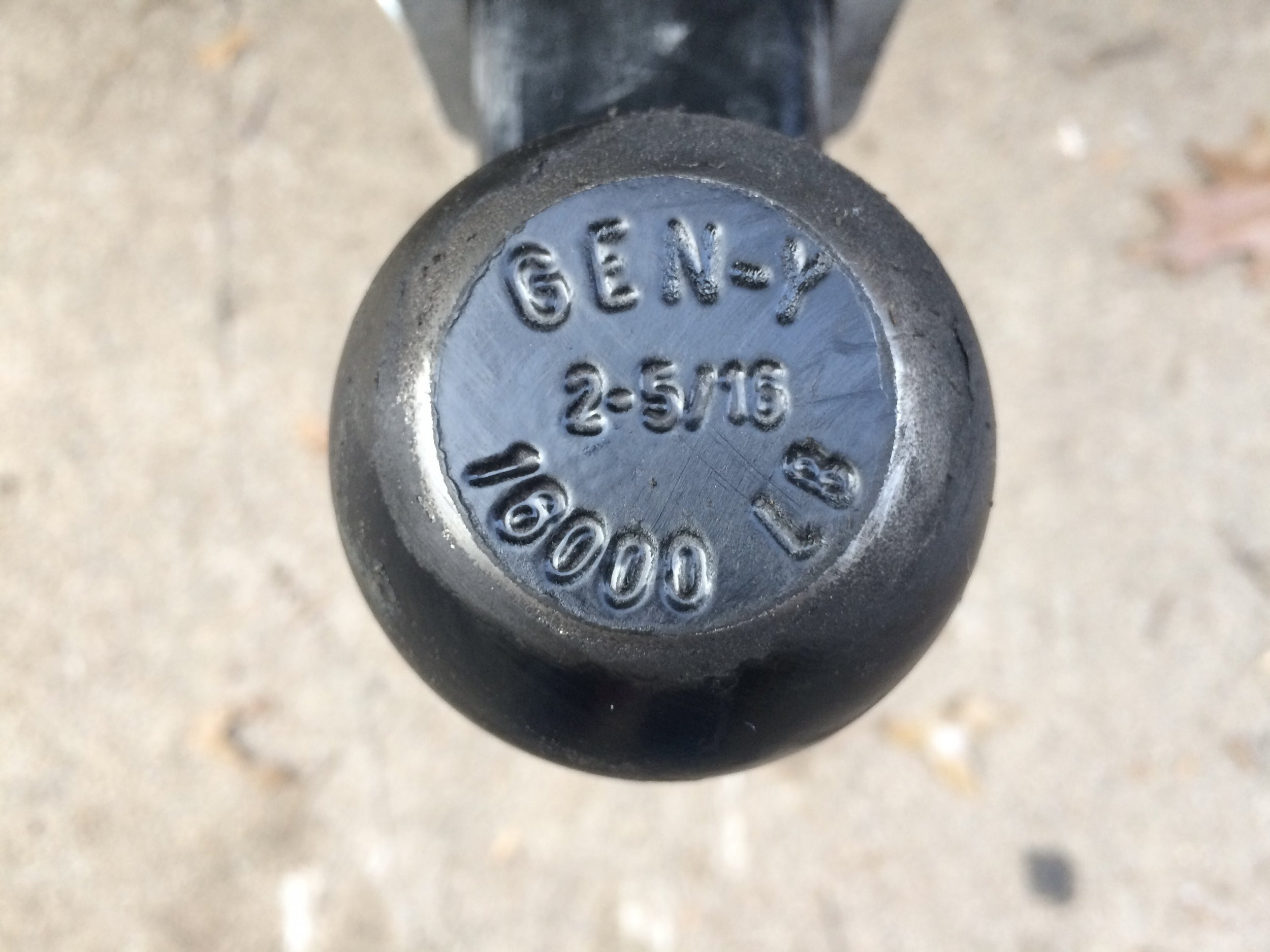

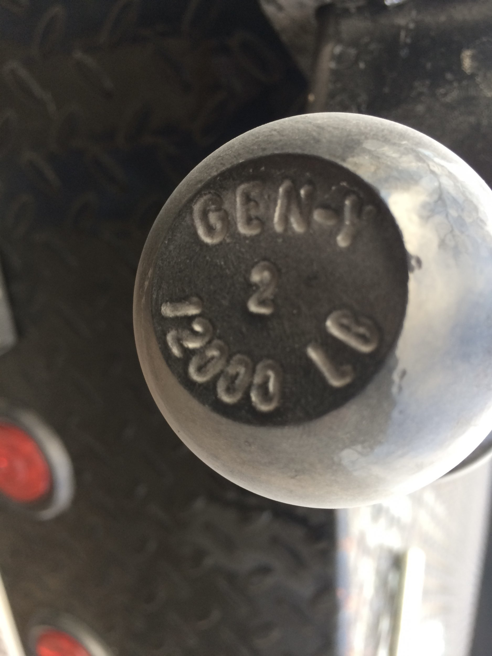

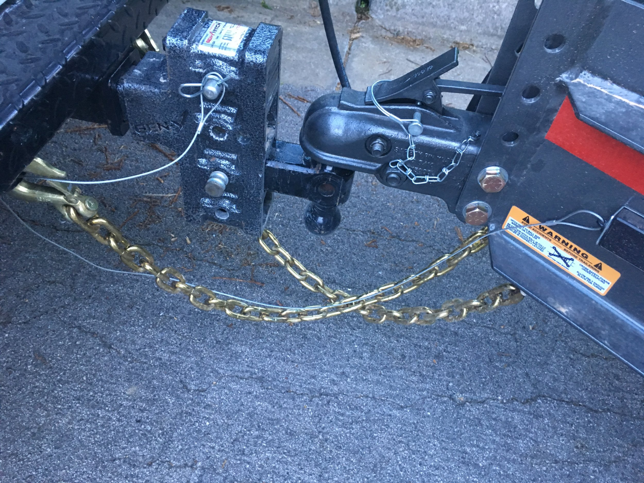

It’s about the weight, not the length or type of trailer, per se. I change all of my bumper pull 2” couplers to 2 5/16”, for extra capability and ease of not changing the ball (even though I just have to flip it over).
I use a Gen-Y that has a 2 5/16” on one side and a 2”, on the other. I can also pull a pintle or a 1 7/8”, with it, after minor adjustments.
My 2 5/16” is rated at 16k and the 2” is rated at 12k.
