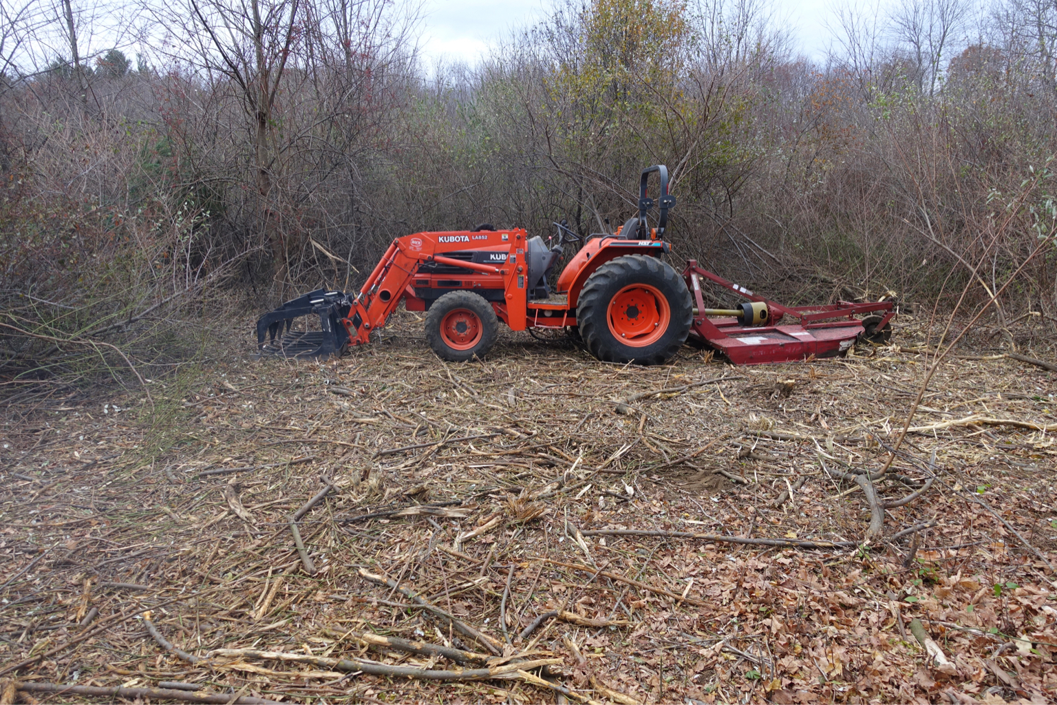

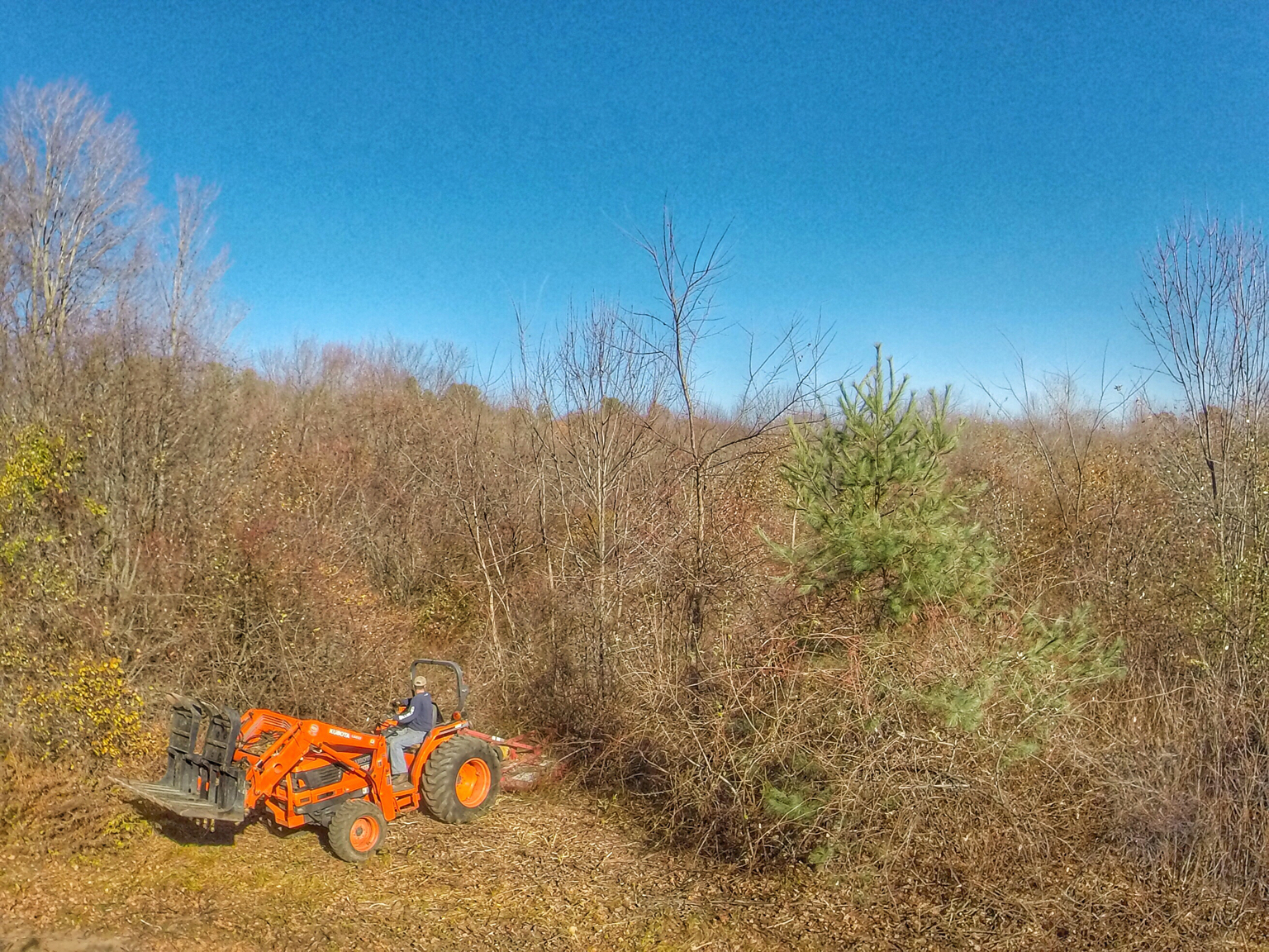

Yep. But working speed due to power wasnt a limiting factor very often. The smaller tires on the L3400 + rough terrain was a limiting factor more often.
I normally mowed in 1-high or 2-high. For that machine that was 4.1 mph and 5.5 I think. Every once in awhile in real thick stuff Id back down to 4-Low, which was 3.5 MPH. And on nasty brush, briars, saplings, etc....3 Low was as slow as I ever had a need to go, That was 2.9 MPH. So more power wouldnt have done much for me on most of the jobs, nothing but burn more fuel.
I did upgrade HP to a MX5100 though. And an 8' Twin mower. I'd be running a 10' Twin if not for trailering and keeping under 102" wide. But that tractor comes at a cost....2.5 Gal per hour if I am pushing it hard. The old L3400 was 1-1.25 gal/hr. SO I have doubled fual usage, for cutting maybe 50% faster.
