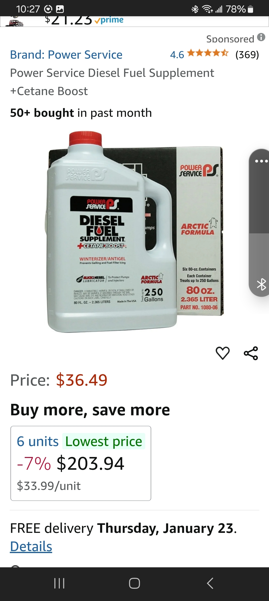

I would add some type of treatment suspecting that you're local oil companies probably don't add anything at all for cold temps. In the northern states it's added as the temperature drops and most still add more.
For a jug of "power service"
It's cheap insurance. This jug treats 250 gallons, way more than you need for a couple of tanks. They do have smaller bottles.
