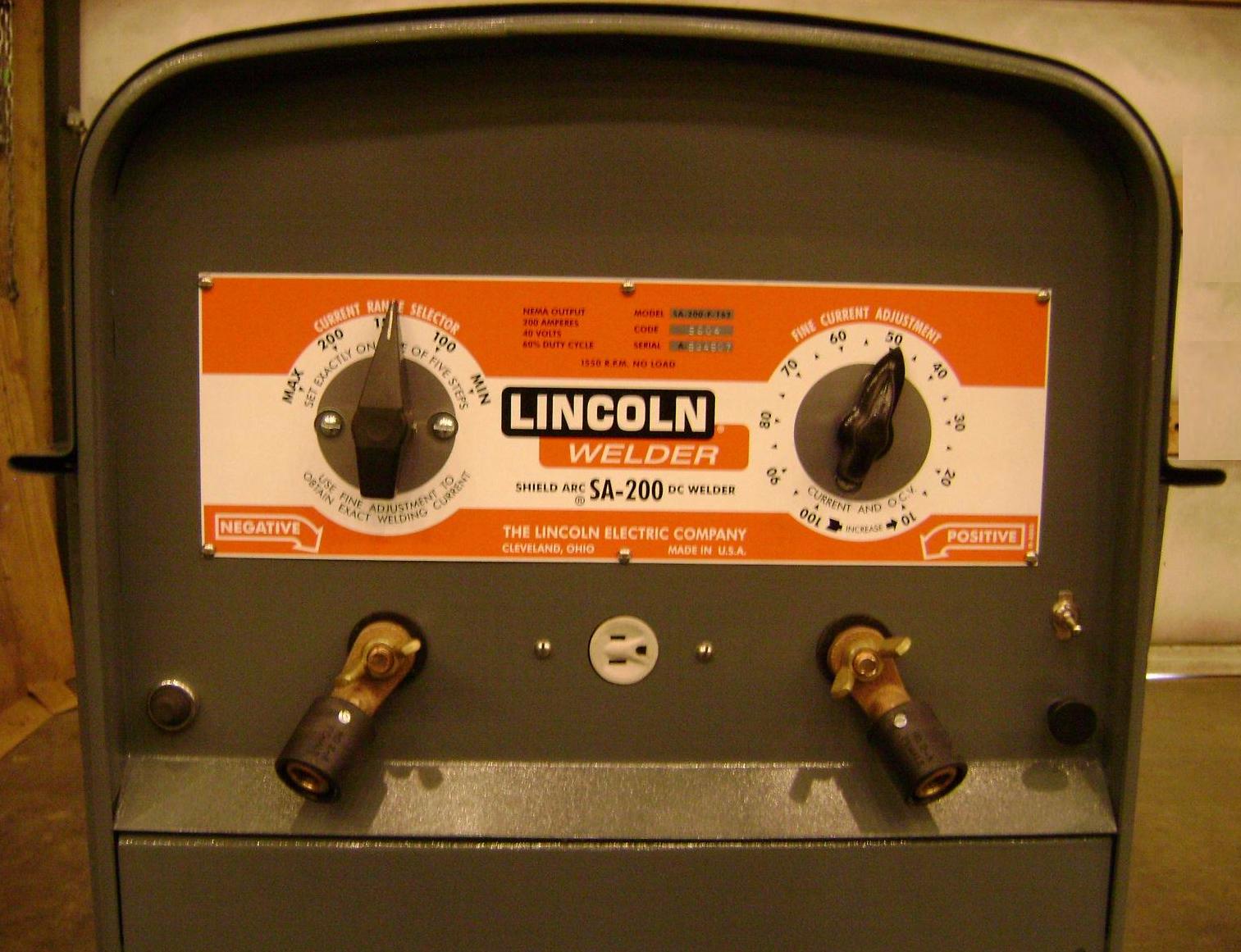

Shield Arc, does the SA-200 have plugs on it to run a grinder or drill? If so, are they DC or AC.
   / what the heck, ac mig welder #14
Yes they have a 120-volt plug, but they're DC ONLY! The older models with vacuum idlers, the idler has to be pinned so the engine stays at high RPM. There is a grind-ease option you can install that will kick the RPM's up to high when you start to grind. I have one SA-200 that has an electronic idler, it will kick up to high RPM when you start to grind.
