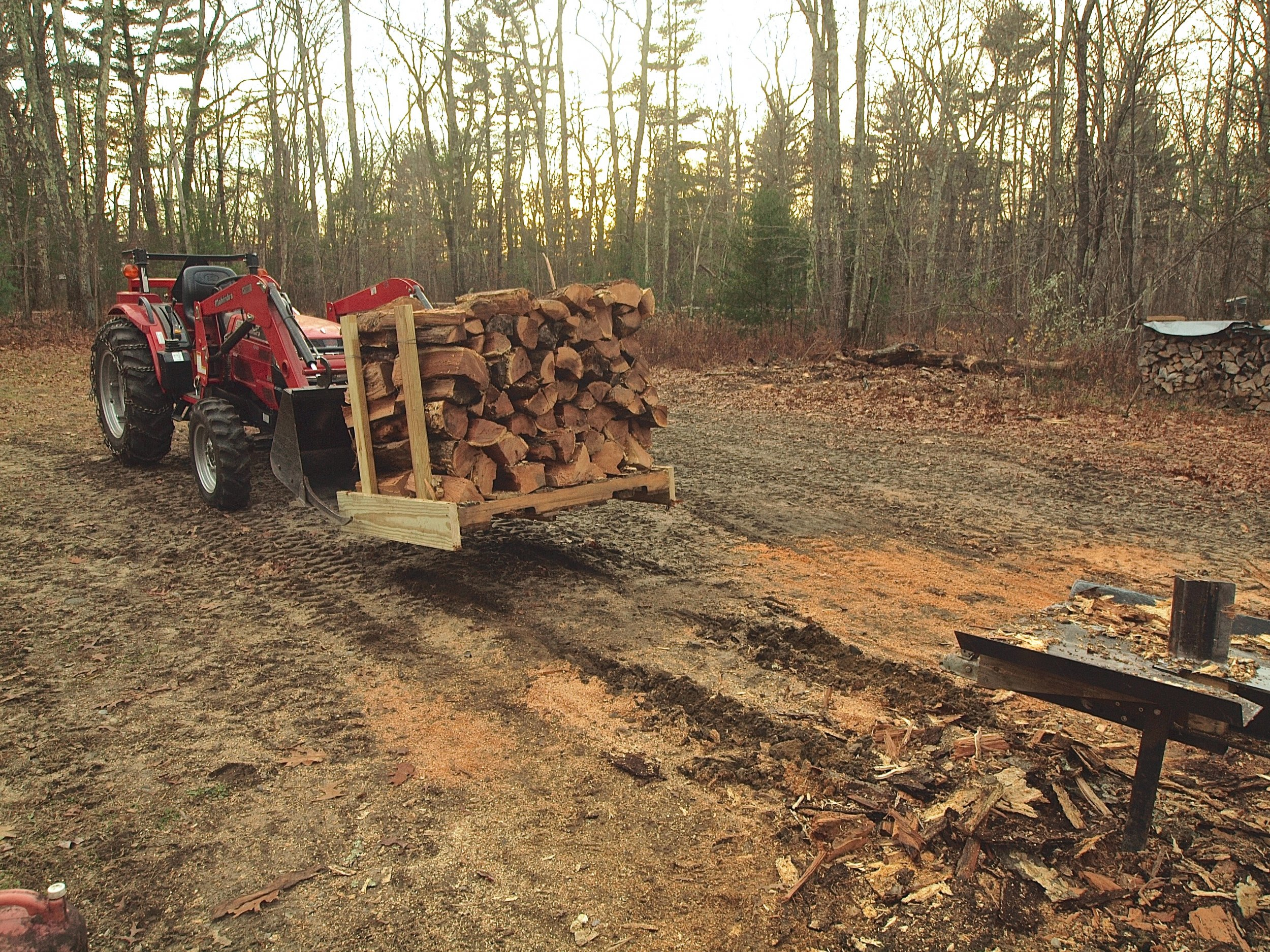

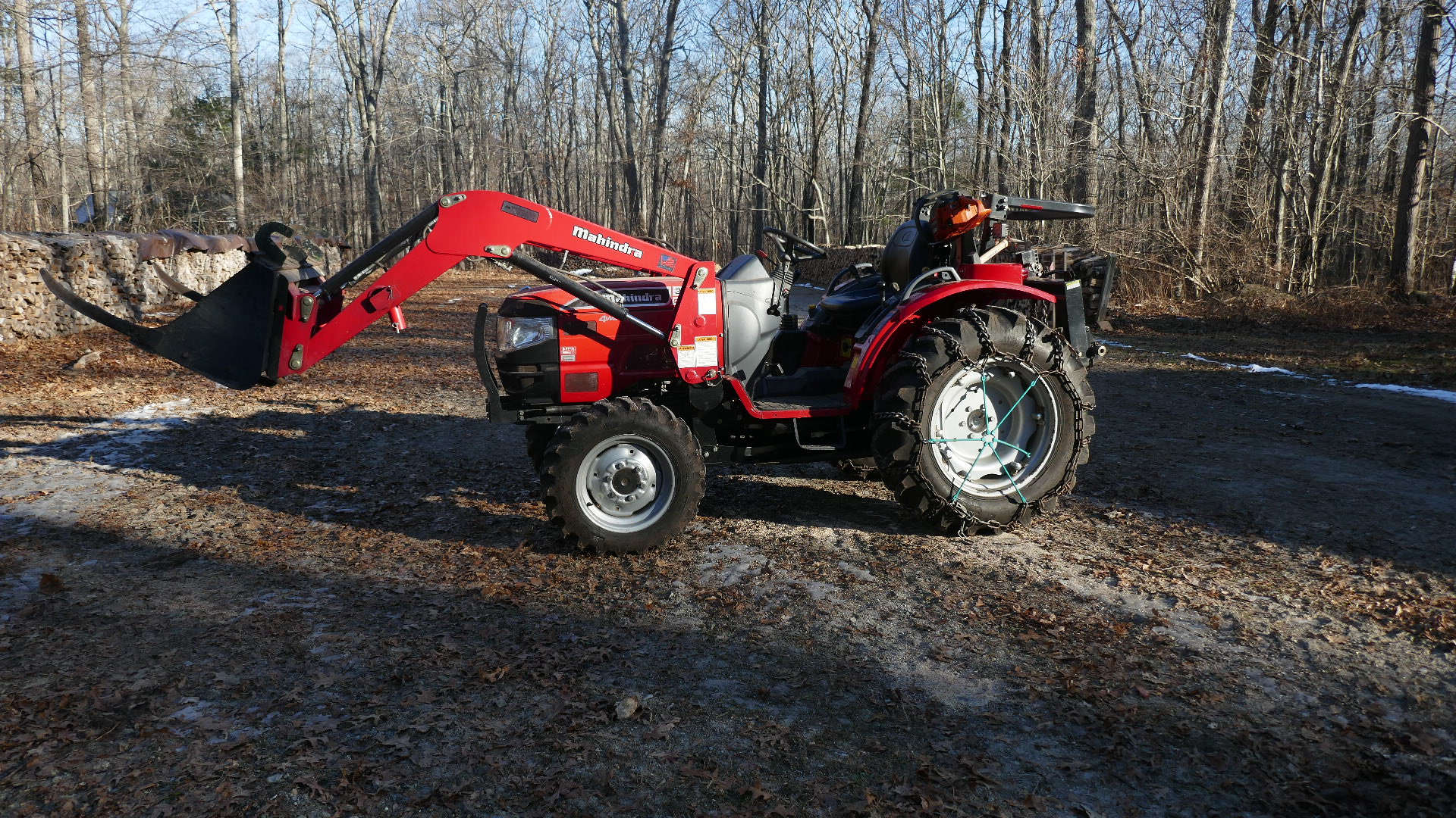

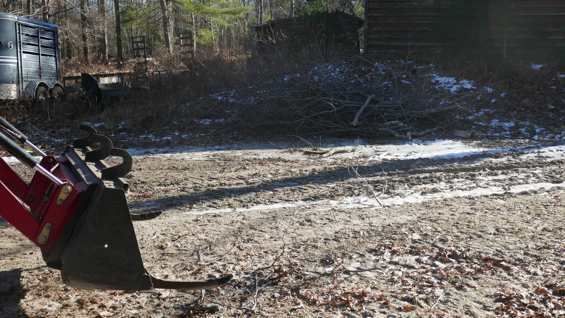

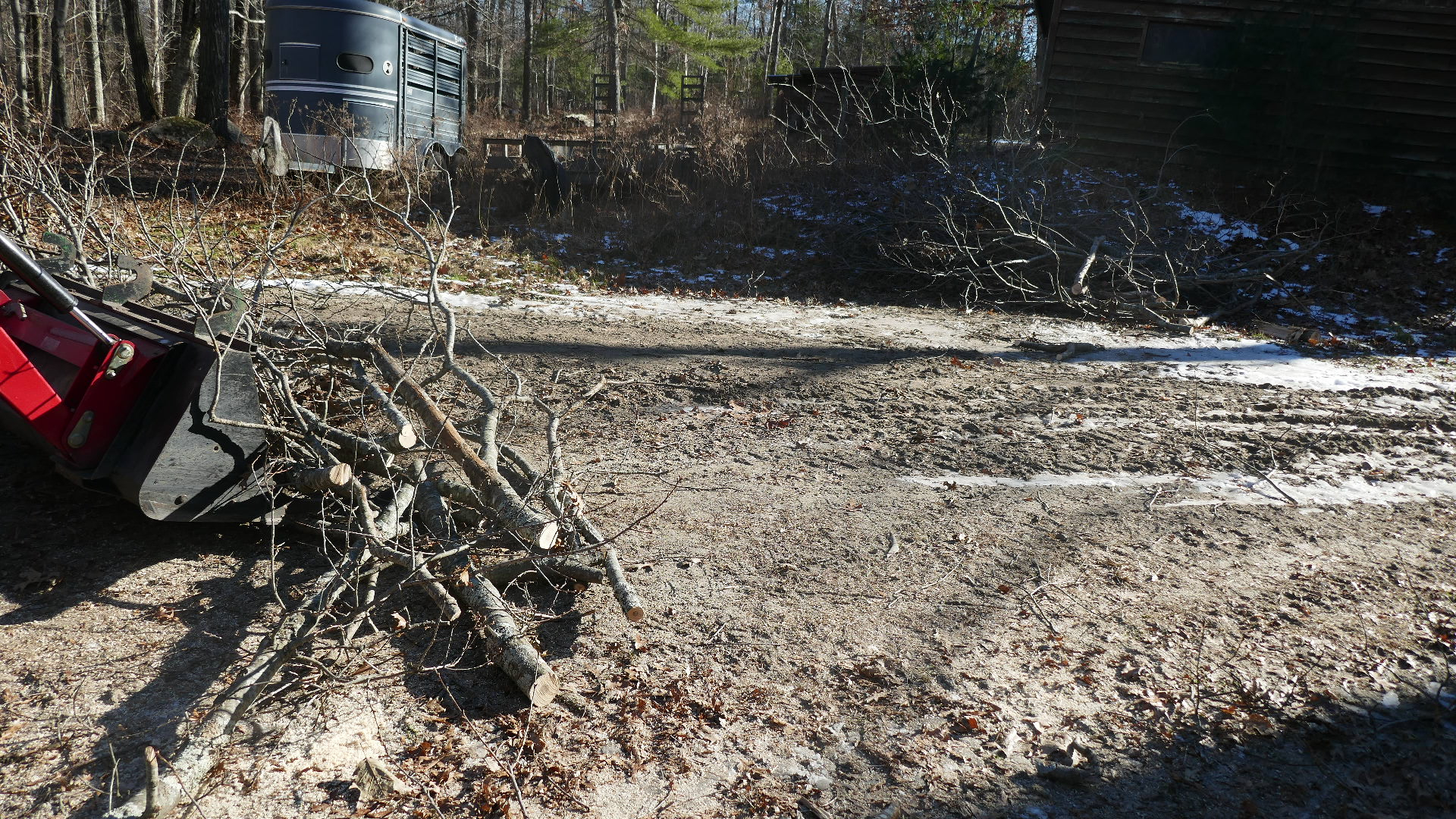

Make yourself some bucket forks for stem lift,. You won't be sorry. They come in handy in a multitude of ways
Mine go all the way to the back of the bucket and cut from a 32" long piece of steel (4"wide x3/4" thick). Held on by two 1/2" bolts per side. $50 to make. Had welding shop cut out shape and then I ran a welding bead for grip and strength along the top..

Here's a close up of the tine to give an idea on how it goes fat to thin and how its bolted on
