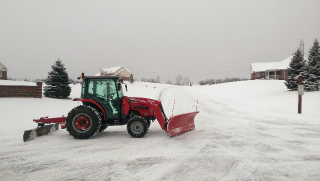

That's a nice looking tractor. I just have a rear grader blade on my FE35 and my neck and torso get sore spending so many hours looking backwards.
I would like to plow the snow and clean up with the blower where appropriate, so a blade on an FEL is high on my wishlist.

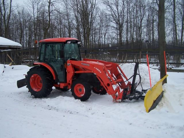

Make sure you get the SSQA for the FEL,makes it a lot easier changing implements in the front.I like my FEL mounted snow plow(8ft).If you are plowing gravel;get one that floats the plow not the FEL.
My main tractor is an L4240HSTC,so similar size to what you are looking at.I also run a seven ft.rear blade in the winter.

can you give more detail on your front blade?
brand, float, etc.
I haven't seen one that had the chain like a truck plow and certainly not that tall.
I have no FEL experience, so while understanding what "float" is, I haven't seen it in operation.

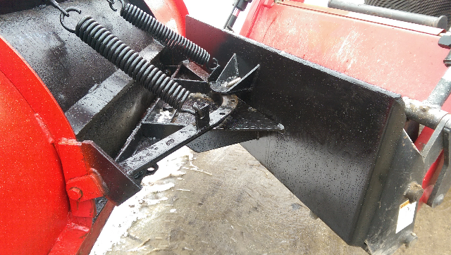

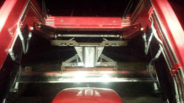

I made my own SSQA plow, using a western plow blade. I still haven't added a hydraulic cylinder, so it's manual turn (which is fine for now). But, I picked up the blade used for about $175, and have maybe another $175 in steel. If you can weld/fab, it's easy. It probably wouldn't cost all that much to have a metal shop do it.

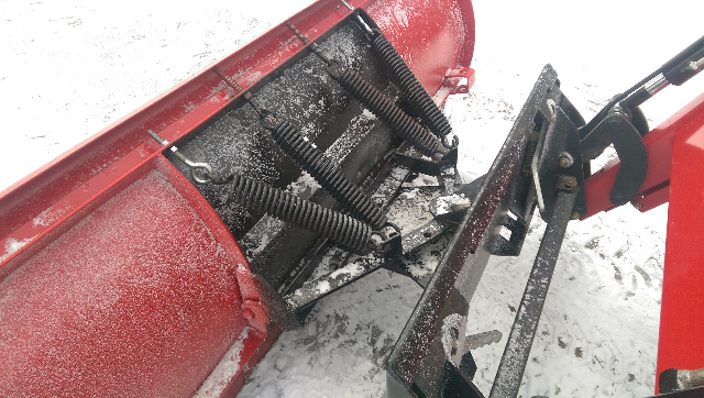

My plow is just an old Fisher eight foot with wings I made a attachment plate for. It uses the truck plow pistons for power angle of the loader third function( An option you'll find you like). It floats on the chain just like it did while on a pickup.
