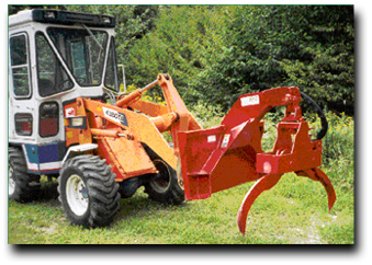

Rarely does chain fling back when it snaps. The reason being is that the weight of the chain weighs much more that the end hook or loop. It will usually just drop. Some chains are designed for pulling, and some are designed for lifting. In most logging situations, chains are used. Maybe something like the picture below might be useful.
