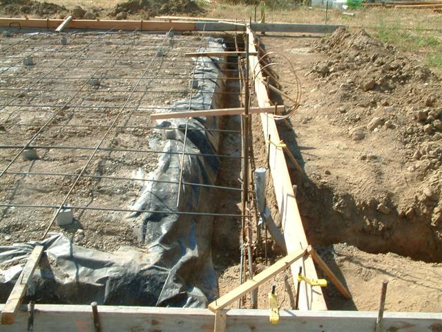

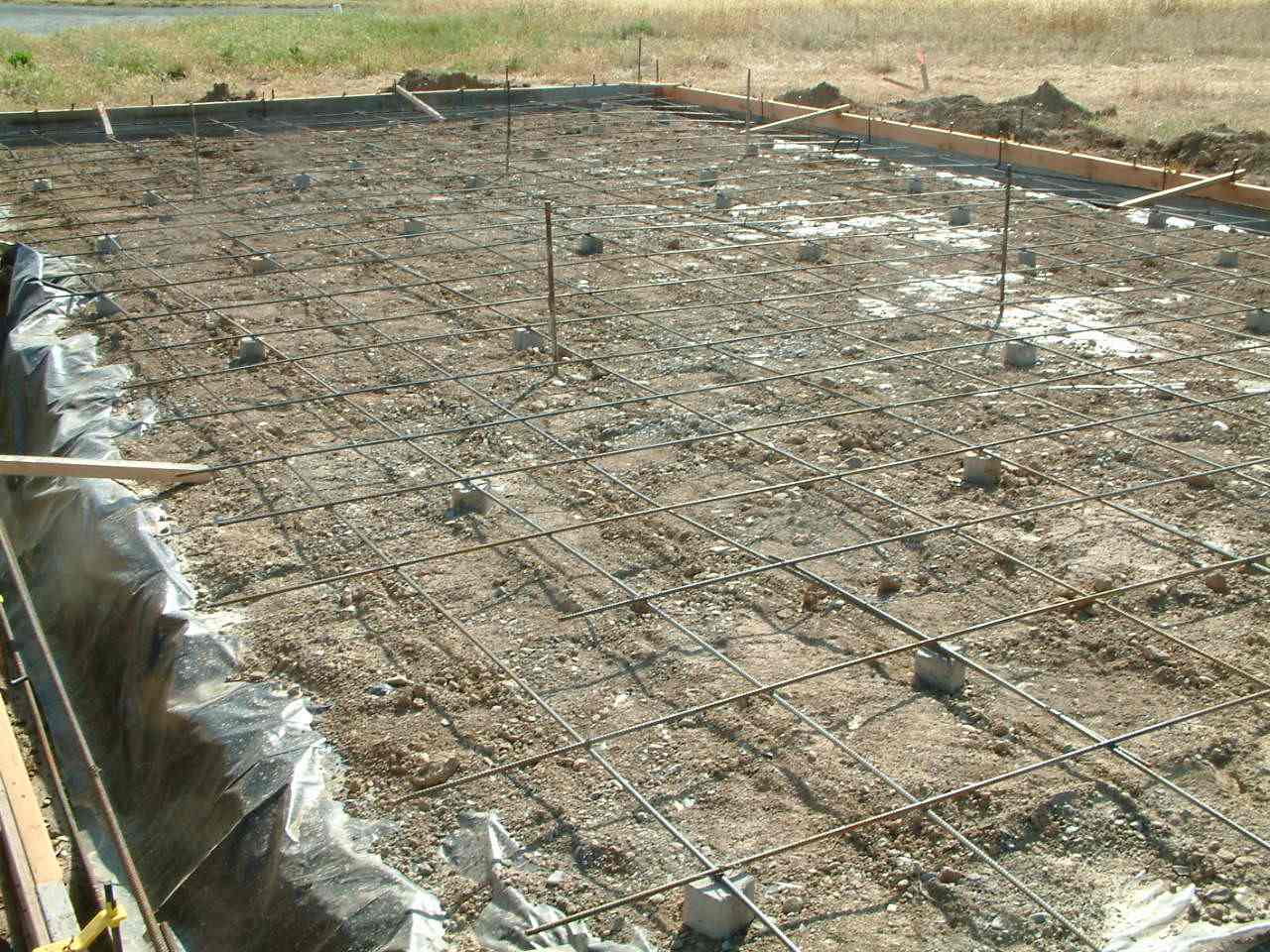

I am having a 50x50 shop being built. They have the forms set. I already put in the pipes for a future toilet and sink and ran a conduit for the lectrical coming in. Any thing else I should consider putting in before they pour the slab?
Before I poured the slab for my 24x42 ft shop, I had to connect a 4/0 cable to the rebar to satisfy the building code for electric ground. Also, 6-mil black Visqueen plastic vapor barrier was installed over the gravel base.
