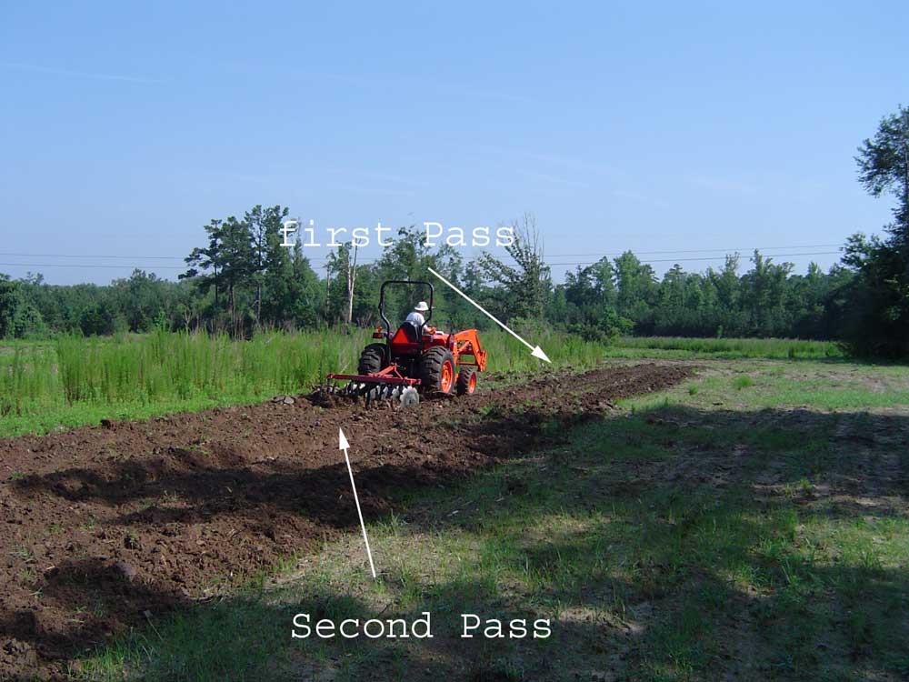

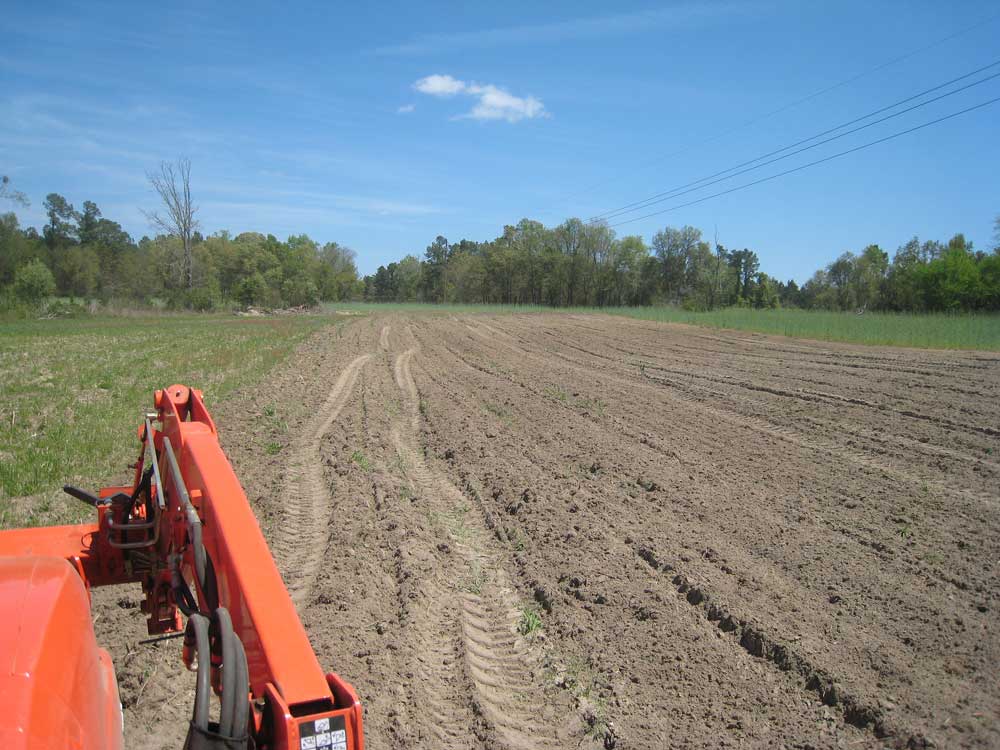

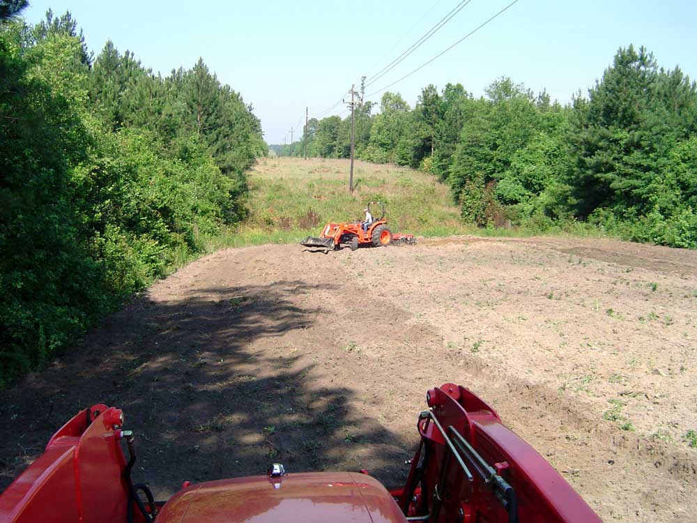

   / What to do before tilling? #30
The fun part about all of this is getting seat time and fun playing with all of the toys and being lucky to have friends like "redbug" who has helped me out with farm projects.
