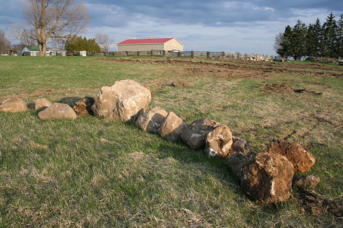

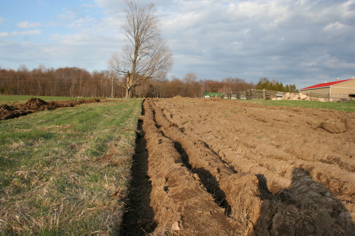

I am expanding my garden here right now. I am plowing then I'll pick all the larger stones that I can see, then in a week or so I'll rototill it all. This spot has not been plowed since the 1930's and the farmer left lot's of big stones in the ground. The plow is really good at finding the big ones.
