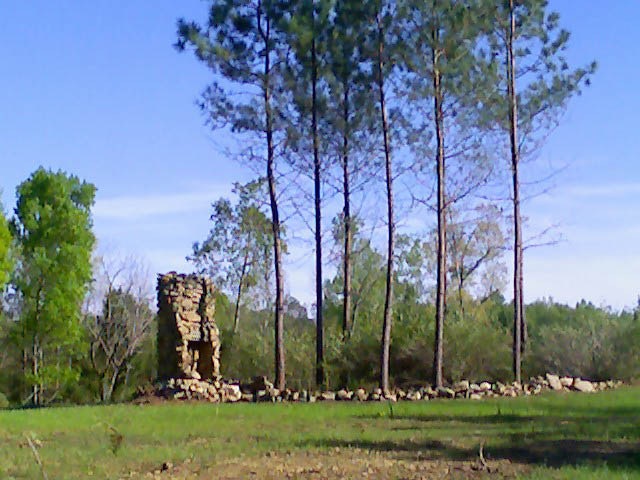

Here's what I did...rebuilt an old chimney and built a short wall around the area...whenever it rains I get more rocks! I think they breed undergound on moonless nights! Photo is attached

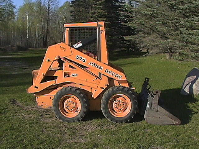

I just bought a rock windrower. (A 9' harley rake type with 6" teeth.)
Since your rocks are smaller sized - how about renting a massive roller & pressing them back into the ground - easiest! This will leave the field smooth as well.
A Haybuster 106 is a combination windrower, ferris wheel picker - cleaner, and a dump wagon on the rear. $15K new but works. Pull it behind your tractor and dump the box when full. Leaves the dirt behind.
Rock buckets will pick up dirt with the rocks and if you have sod, it will pick up a lot of it.
The rock hound works until smaller rocks jam the rake tines and you need to stop & reverse clear it.
A rock picker bucket type is good for larger rocks that are not easily windrowed. Has the same problem as a rock bucket with dirt & sod. Rotating rake style picker is better but has rockhound jamming problems priced at $6K and up...
My rock tools range from a dozer to this little thing I just put in the barn - 28 HP and can easily can see the front pickup edge. The rock picker attachment is a modified manure bucket still under construction.
