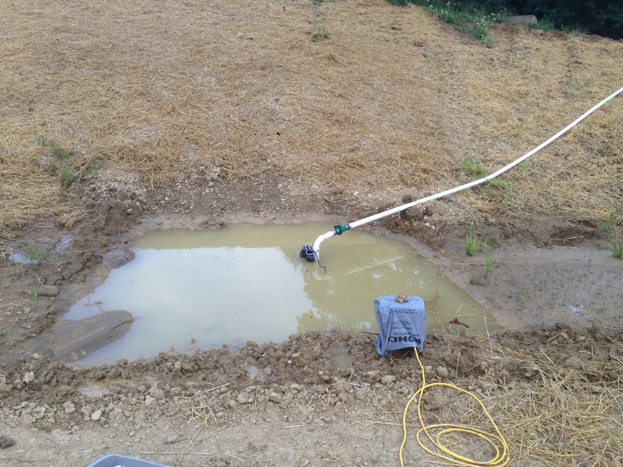

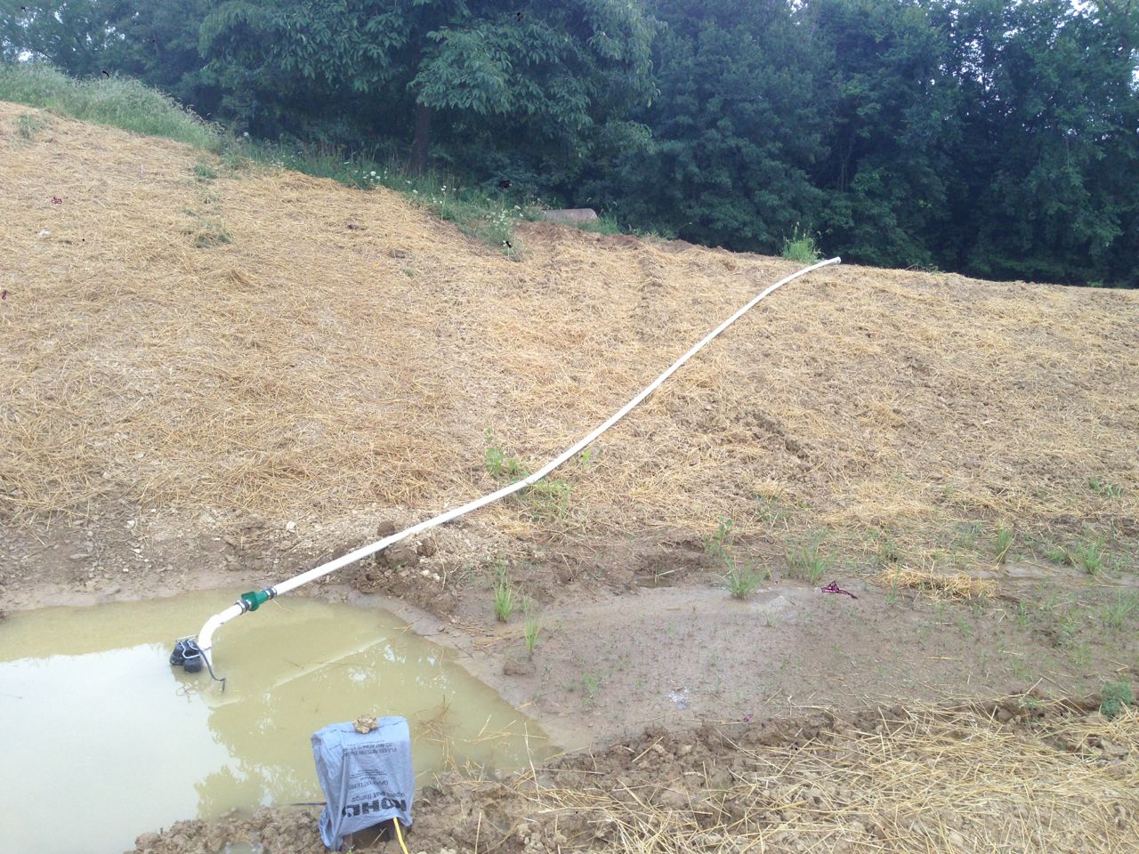

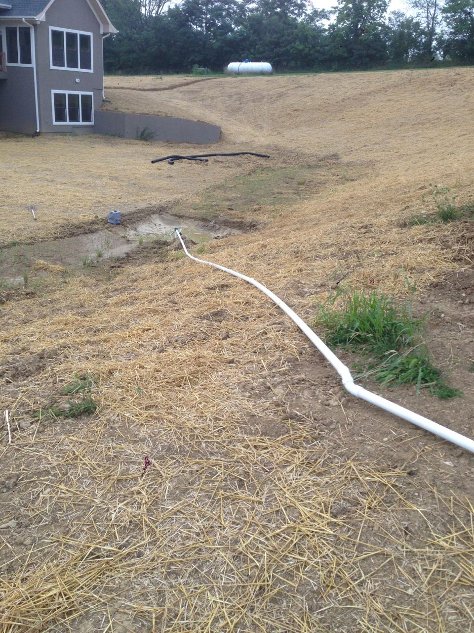

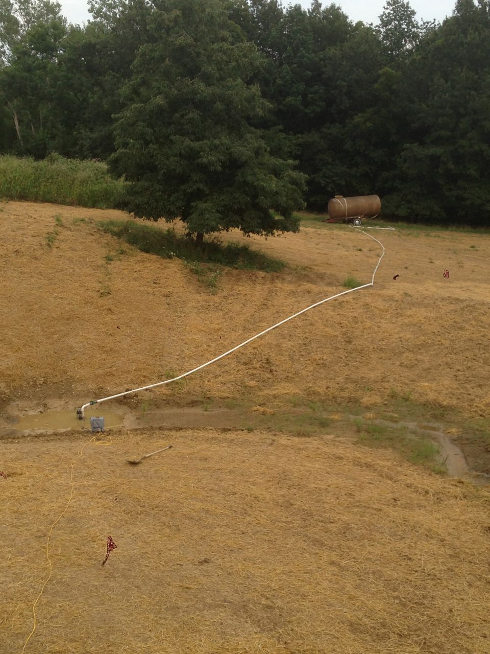

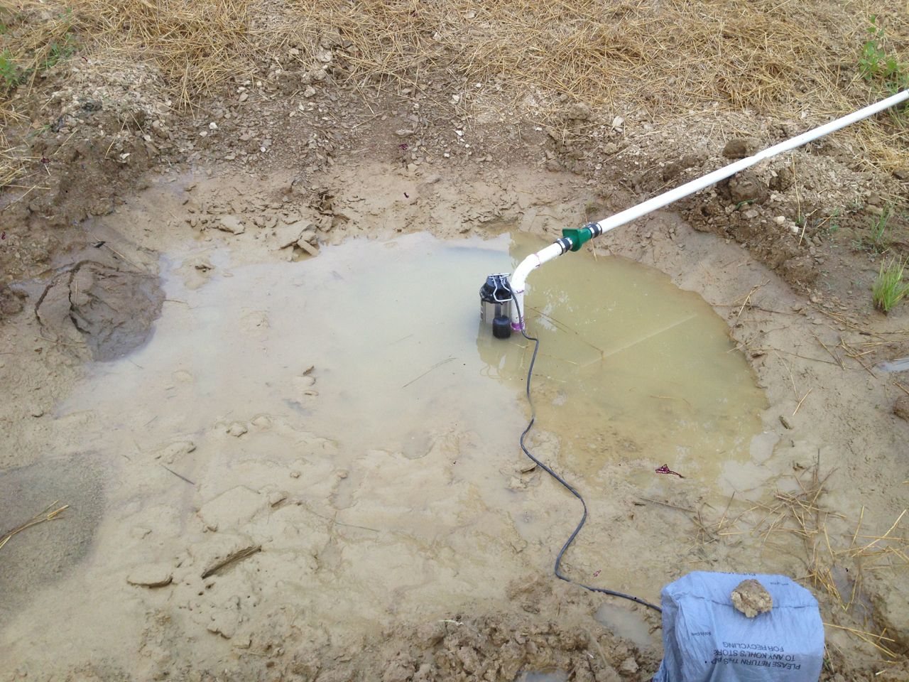

So my Wayne pump came today and I rigged this up tonight after work. Based off GPM and how long the pump ran I estimate 400 gallons on the hole I dug. It takes about 4 hours to fill up.
Next step is to take the tank off the trailer and dig a half moon hole to put it in. Build a top, and make the install more perm overall.

   / What to do with leaking hillside? #35
It is looking nice.
How are you getting the water out of the tank? Why not move the tank to the highest spot in the area, and perhaps add a stand for gravity feed.
I've been considering the difference between an elevated vertical and horizontal tank. It might take up less space and perhaps get more height with a vertical tank, but the pressure will be more uniform with the horizontal.
I've been using low pressure... and it is a bit of a pain, so perhaps a second booster pump is best anyway.
#36
Actually I dont have the water going into the tank yet. Ran out of daylight last night. I need to clean the tank, and build some sort of cover for the inlet and figure out how to do an overflow. I want the water to go into the tank, then if the tank gets full have it spill out into the creek basically.
For the irrigation I plan on getting some sort of pump that I can sit in the bottom of the tank and turn it on to water the garden we will be starting in the spring.
For now I am just needing to get the back area around the house and the bottom of the hill dry enough so I can get it graded and seed down, so I can have a nice runoff area for rain. Right now if i walk on that dirt i sink down calf deep, let alone a tractor...
