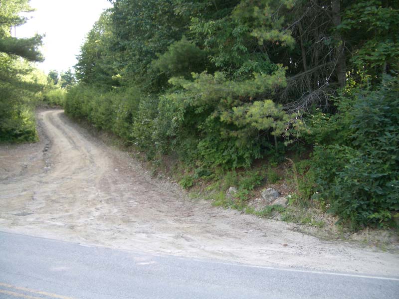

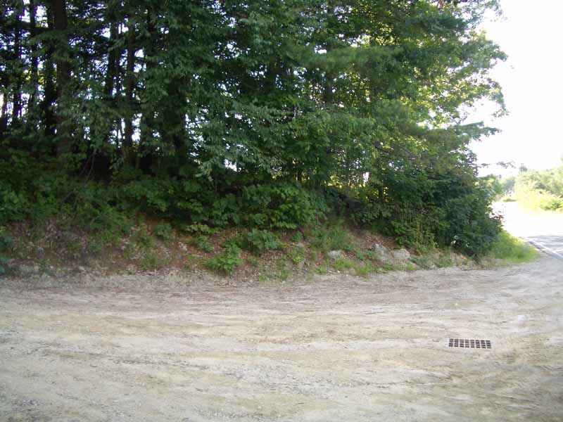

It would sure be nice to see a picture of the proposed road area. Could make a difference on equipment suggestions and how to aproach the job.

We must have pictures.
