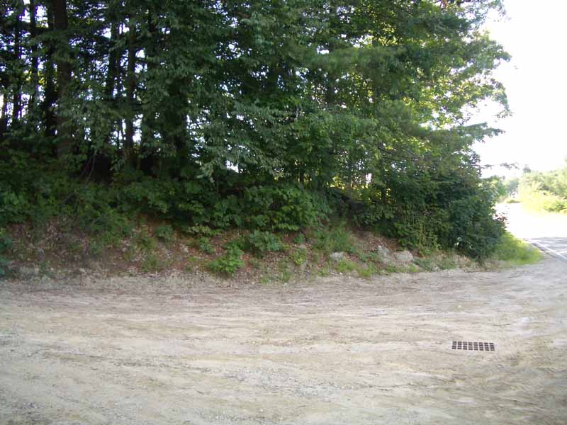

Here is a picture of the existing driveway (17% grade) up the front. The state requires that the first 20' be level, and then put in a couple switchbacks to lower the slope to 12%. All the trees in this picture will be taken out to allow for sitework. The steep parts are on both sides of the driveway.

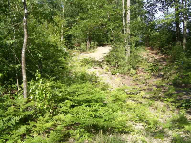

Here is a profile shot showing the start of the slope that has to be cut away and the remainder left at a 1:2 grade.

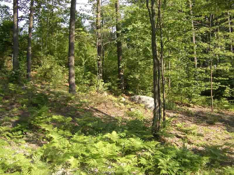

Here is a shot of the backside of the hill. Most of the trees to the left of the center sandy portion will be removed for the road. I'm hoping that since it's a sort of ridge, I can come at it from the side and have fewer issues with slopes while using the machinery.

Here is a profile shot of the backside slope. It's a bit steeper than the frontside. /forums/images/graemlins/smile.gif

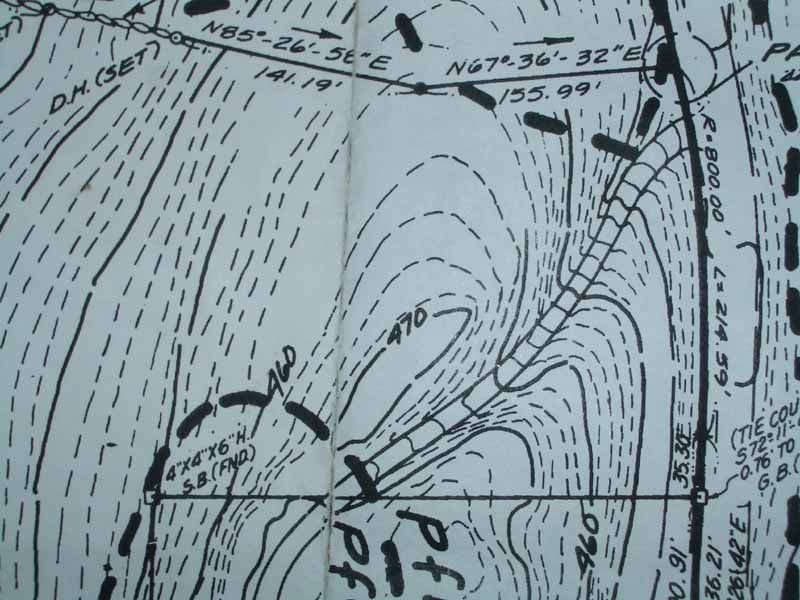

Finally, here is a topo map made from an aerial scan of the property. The driveway indicated is more or less as the existing driveway appears. That 470' peak (about 30' above the road) is the main source of all the fill that's got to move.
