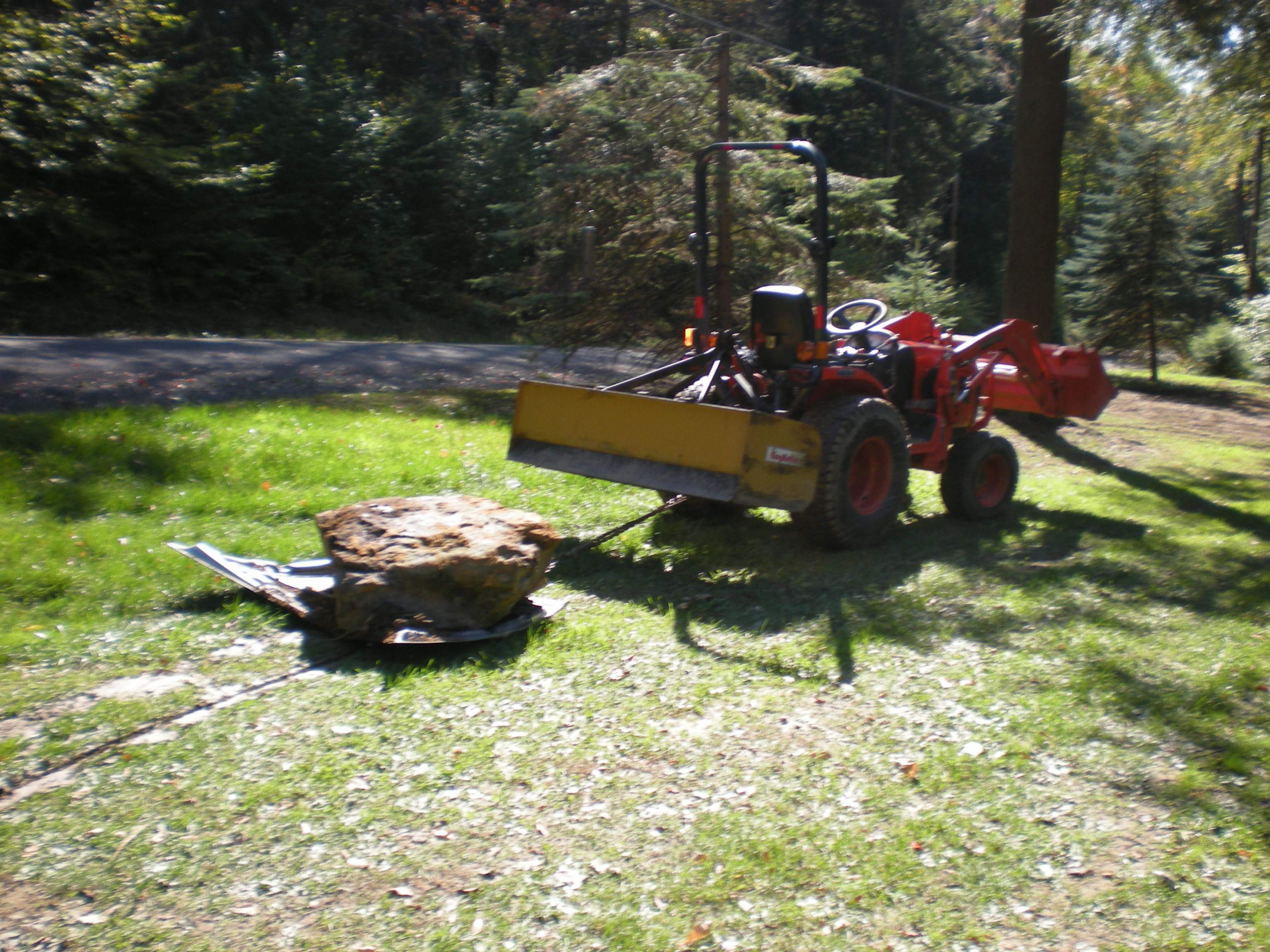

The photo greg g posted in a link has a feature you should look for. That is, a clevis-style type of hook-up. Some of the other photos don't have it.
Here is what it looks like. Don't mind the extra junk on the pin in the photo. Just look at how it is constructed. Much stronger.
   / What to look for in a BB scraper #10
