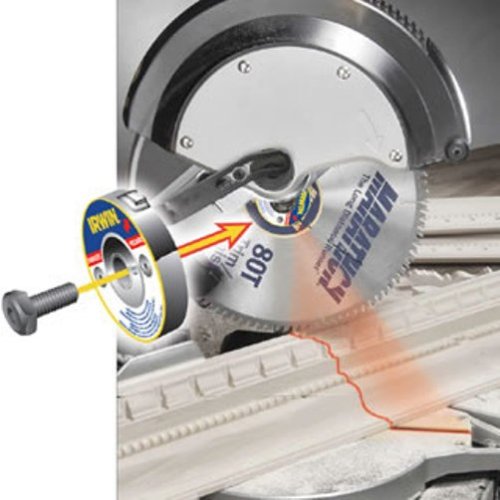

As to the laser thing, I guess I don't understand it's usefulness. I have always just gently set the static blade down on the work to see where the teeth of the blade will hit on the mark. I don't understand how a laser could make this any better or more precise?:confused3: I just don't see the need for it.
   / What to look for in a compound miter saw? #48
James, my laser has never been accurate. Maybe it's adjustable but like you I don't see the point. Mark board, lower saw. Since you actually have to start saw to see the laser you'd have to wait for saw to stop or move board around under moving blade to adjust anyway.

Every laser saw I've used always stays on.
If they are set properly and accurate they are much nicer for production cuts. If you're doing trim in a house it'll save at the least a few seconds every cut. Over a fee hundred cuts you've saved a lunchbreak of time. That can be each day trimming out a home.
Time is money. Lasers are a great tool when used properly. They have also gotten better. Ten years ago they were gimmicky but most saws now they are tip top.
Don't need to lower saw and bend and look. Just slide board in and you see the line. Match with your pencil line and cut.

I have one of those laser addons and it works well for me. My saw has a blade guard so there is no safety issue. Just turn the saw on, the laser marks the cut line, slide the workpiece with my cut mark to the laser line then either clamp or hold and make the cut. Easy peasy and spot on every time.

Don't buy a laser. The laser bleeds on the edges and is super hard to see. Every tool I have that has a laser also has duct tape covering the laser so I can accurately follow a line.
