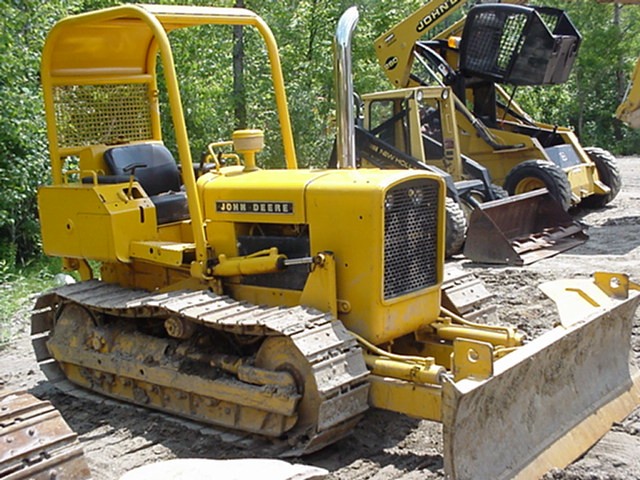

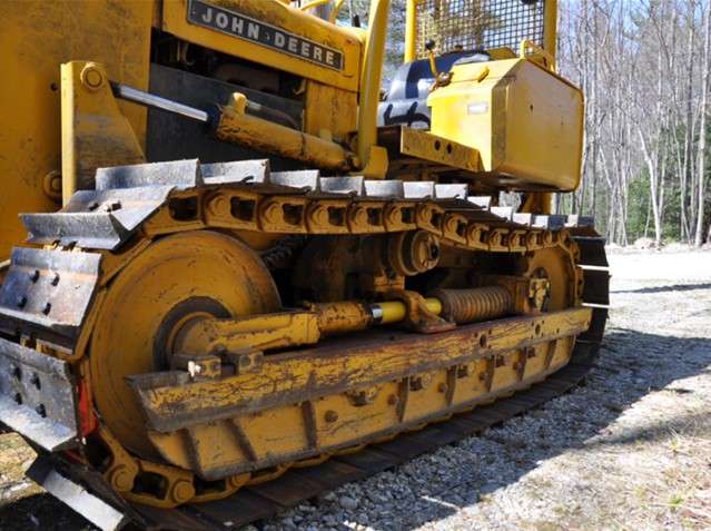

I've owned my JD 350C since about 2002 and it has always served me well without a lot of issues. The biggest thing I did to it besides putting on new tracks two years ago was to have the injector pump rebuilt which cost me about $750 about 10 years ago.
Here's a pic of mine on the dealer's lot when I bought it.
And here's a pic of it with the new tracks:
