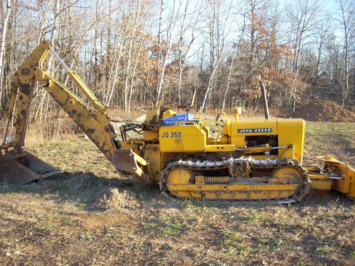

here is my 350 power steering and power reverser.
