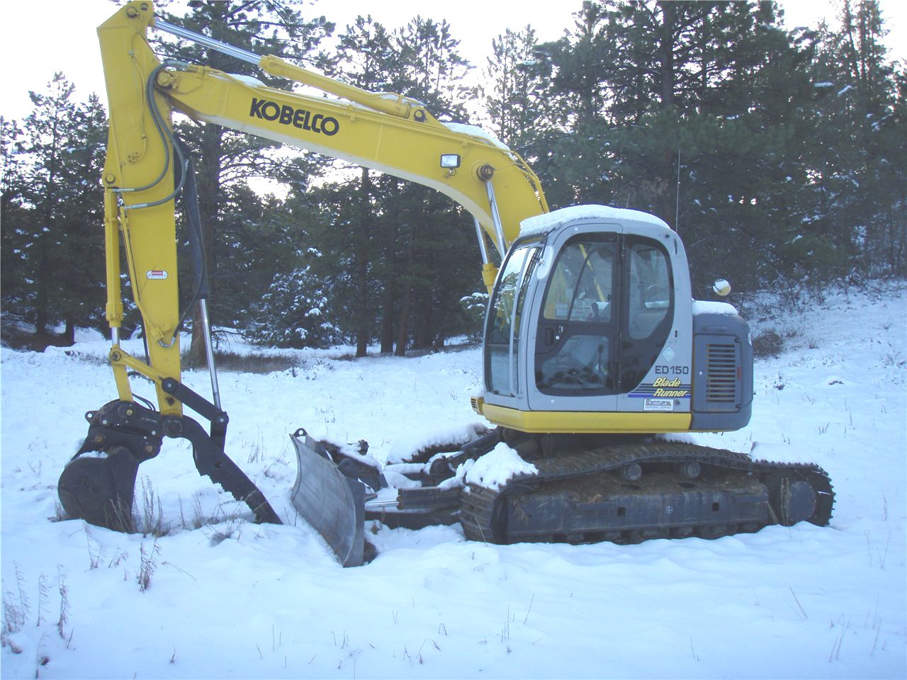

An excavator w/ a dozer blade is a good combo if you don't have too much heavy dozing you want to do. The kobelco bladerunner is a good machine. It can do a little more since it has a 6-way blade. Deere 120's and 135's are also well made machines. I've never used one with a blade but I've used Deere 120's and they are great machines. They are however, expensive.
