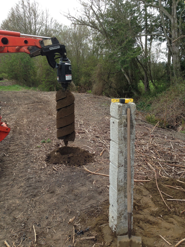

I Made concrete posts after 30 years of replacing wood posts - 6" X 6" posts with 4 5/16" rio bar- you can adapt your wood mould to suit gate mounts and latches. Wont rot in the hole and become loose and will handle a scrub fire. Bit of setting up but if you have more than one to do this could be an option.
Good strong mix is essential - 32mpa concrete
So did I. Can you post a picture of your setup?
