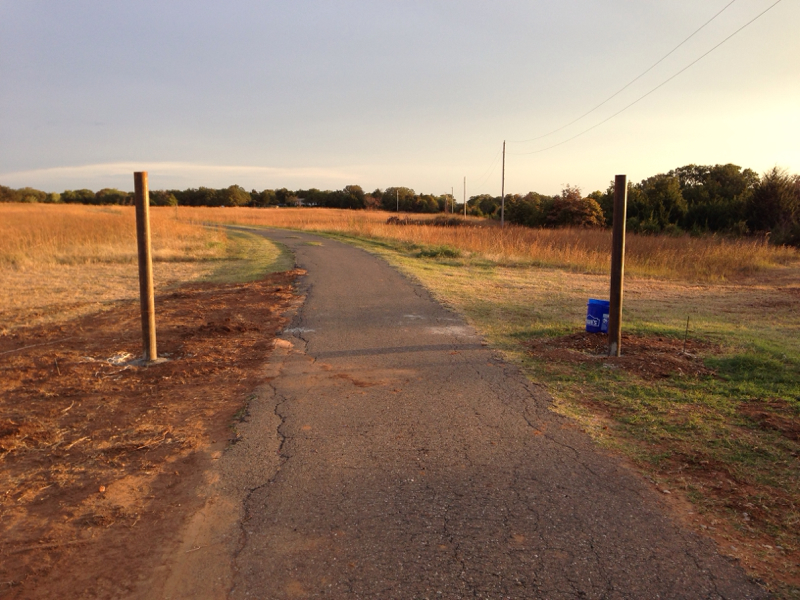

Great thread, found more information here than searching Google for an hour. I'm probably just going to go with a couple of galvanized steel pipes, maybe some treated lumber, however, if I decided to build a couple of rock pillars, what would be the best way to attach the gate to the stone?
/ What to use for gate posts #46

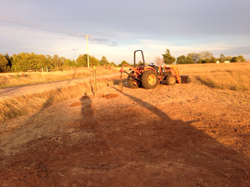

I used 4 and a half inch steel pipe sunk in holes about 4 feet deep with added concrete for a somewhat heavy 14 foot swinging and decorative gate. That was years ago and I know I overbuilt it - but it has not budged and gate closes perfectly - level and plumb. I am an advocate of building it right once. I bought a 20 foot pipe and cut it down - it was threaded at both ends so I also added a cap.
That was for a main entry gate to our drive way at the highway. For other gates - farm and cattle gates - I have used wood, or other metal posts I already had around. I have braced the posts at the hinged side with other posts and wiring.
