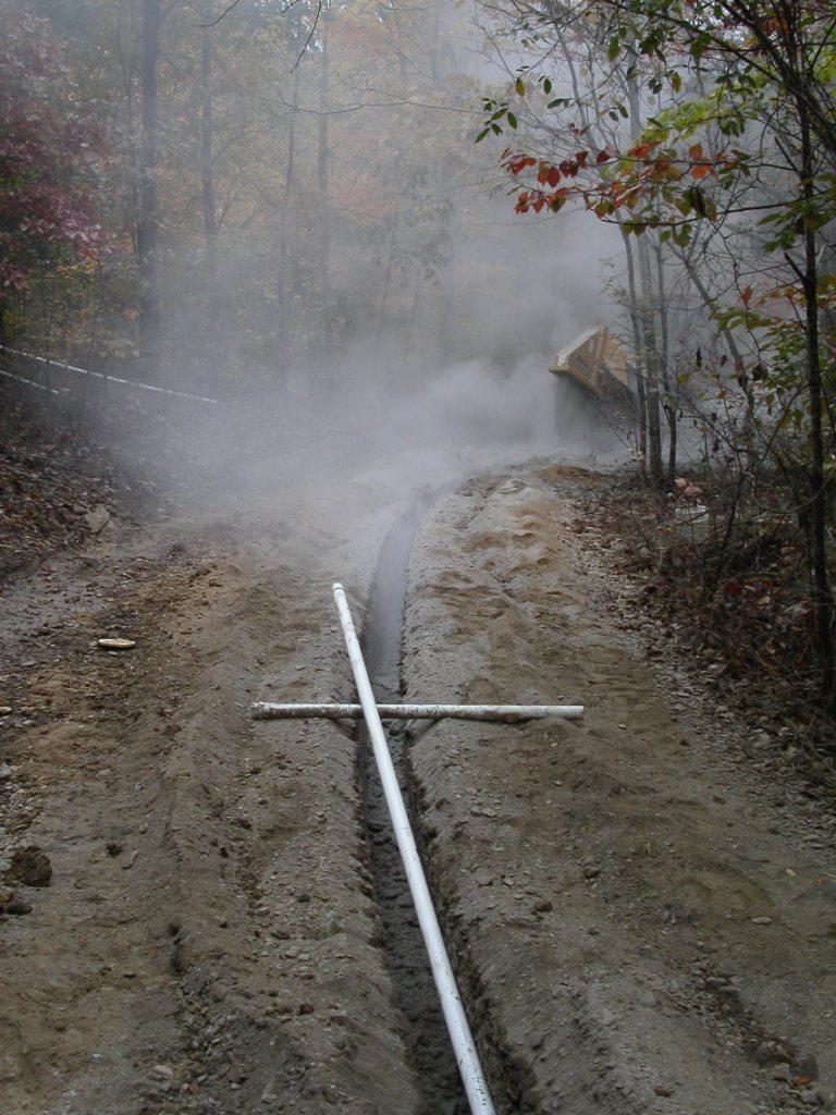

   / What to use for laying Water Lines? #10
Hope you don't have rock! That rocksaw in the background was a little pricey.
- Jay
