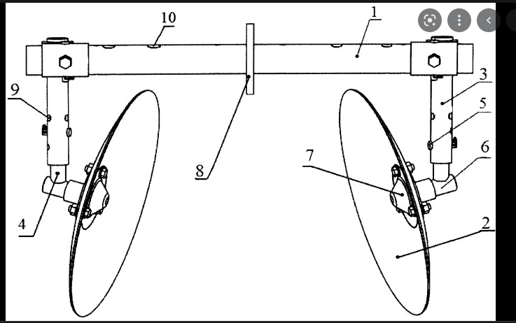

perhaps a disk ridger would do the job.

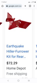

Would one of these work?
