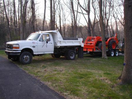

Go ahead and insert foot, unless you want to turn this into a Chevy-Ford thing, which I see no point in.
   / what tractor do you tow with compact truck? #49
RayH...
Now that is a nice setup!!
/forums/images/graemlins/grin.gif
I don't tow my tractor, but plan on getting a setup like yours in the near future for a side business.
