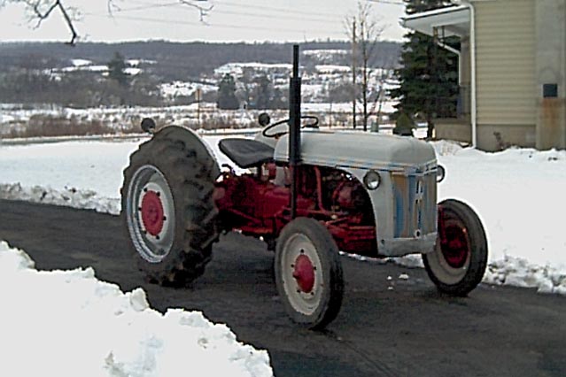

Yeah dont know about Fla, but that is what i actually paid for my tractor last year...seem to be a lot of ford 9/8N and Massey 35/135 (a little more) which are good utility tractors with ez cheap parts, lots of help on the web...
The nicest thing is that ANY mechanic can work on one of these tractors - most guys will say 'oh I had one of those once..." /forums/images/graemlins/grin.gif
