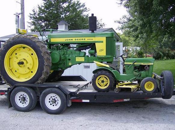

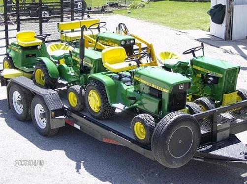

might check with Woodworth Mfg. near Chillicothe, MO, not going to be the cheapest trailer around, but you won't find better quality! They will build whatever you need.
My 8-1/2' x 16' Woodworth;
