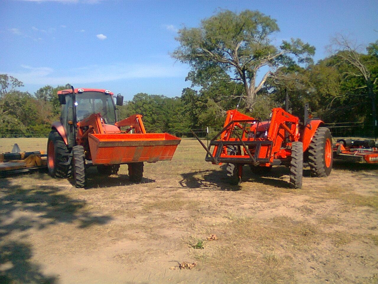

Well I figuerd I would show my tractors that I have so yall get an idea of what im hauling tractor2.JPG
Also truck will be used to haul hay and cattle

Well I figuerd I would show my tractors that I have so yall get an idea of what im haulingView attachment 227033
Your in 1 ton diesel dually territory in my opinion! Maybe 1 ton SRW diesel...
I would even consider buying something bigger than a pickup... something like an F650... You know like a beer tractor trailer. I know there's some nices ones out from Ford, GM and maybe Freight liner. A lot of guys use this size to pull big 5th wheels. Plus you can get CAT engines in some of them! Purrr power!

With the loads you are talking, even your tractors, it is really going to labor a gasser. Gassers are for CUT's and SCUT's. You are looking at what appears to be a 10k towing load at a minimum. With the tractor + trailer.
