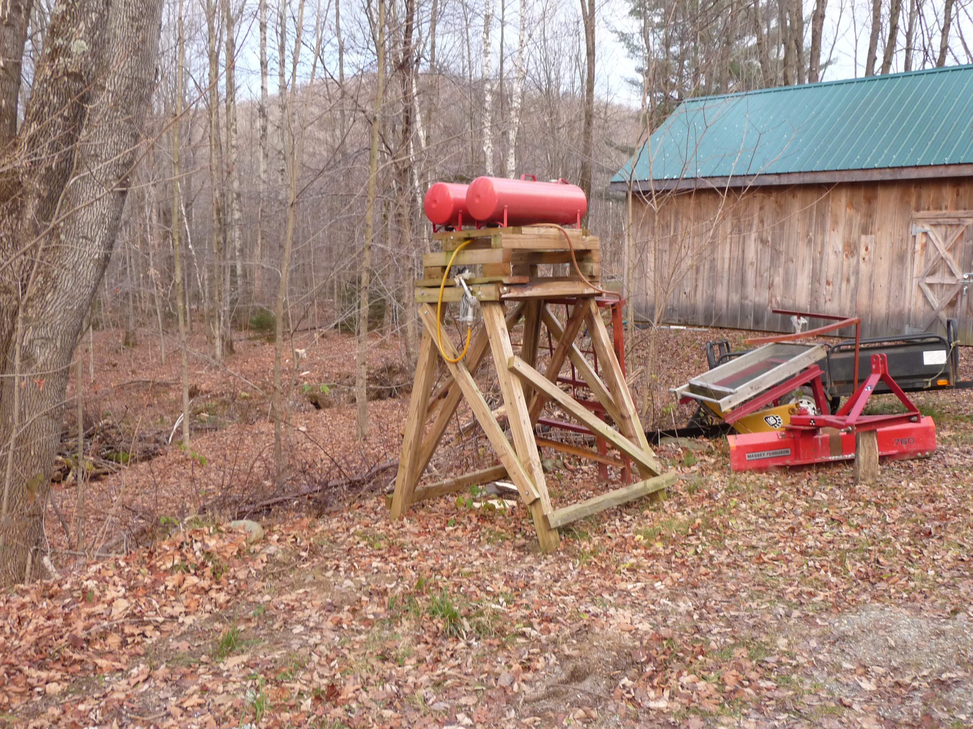

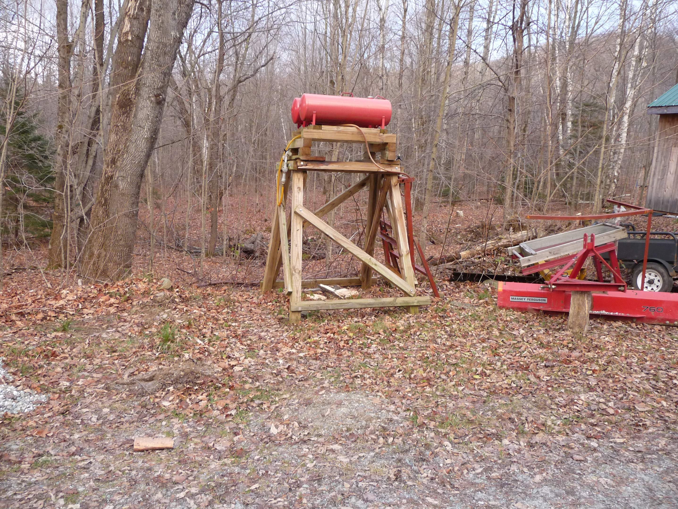

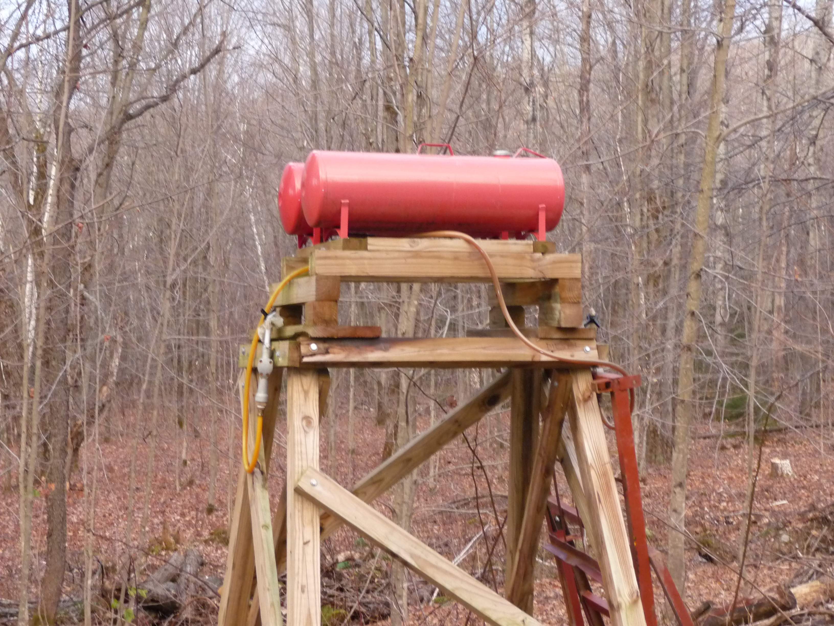

KC- For what it's worth, I built a fueling station for my MF, from some PT lumber and 2 Fuel Stations from Northern Tool. Pics attached. Built it about 3 years ago and it has held up well. When I need to fill the tanks up, I put the bucket forks on the FEL and lift the pallet that the tanks are attached to off of the trestle and onto my trailer. Quick trip to the gas station to fill them up and then I lift them back onto the trestle. Since the tanks sit higher than my tractor, all I do to fuel up is backup to them and open the shutoff valve. Gravity does the rest. Got the Fuel Stations for about $75 each on sale. All told, cost about $200 to build the whole thing.
Cheap- but its worked for me.

Hey Wayne, that looks like a good setup you have there, whats the height to the bottom of your tanks? I could build that with leftover lumber I have stored under my decking, and I could even put it inside my large shed garage which I only store my little fishing boat in.

Hey Kc- been away for a bit. Hght to bottom of tanks is about 7'. This gives about a foot drop between the tanks and the fill cap on my MF. Probably could have gone a little shorter, but I pretty much was making all this up as I was building it! About the only thing I plan to add in the future is nail some ladder rungs on the side to make it easier to climb up to the tanks and check them.
Wayne

Thanks for the additional information from your caddy support system. I think I am going to go with two tanks for diesel only. I also plan on installing a containment berm using a 2" x 8" wooden framed permiter box sized about 4ft. +- x 3f.t +- and lined with a heavy black plastic liner (should contain about 52 galons), just in case something gives away and that should protect me from diesel flowing into the ground. About plastic drums and plastic caddys, its been -27 degrees here already and the highs -9 and I do not want a plastic frozen plastic container on my property. It might be just me, but I remember plastic and cold is not a great idea? One more question for you, did you connect the tanks together with a tee and use only one filler nozzle and shut off valve, thats what I am thinking of doing? KC

As for the filler hoses and nozzles, each tank came with a shut off valve and nozzle. Originally, I used one tank for diesel and one for gas ( for my riding mower and ATV). So I didn't connect them. But I found that I was using more diesel than gas, so I now use them both for diesel. Haven't found the time or motivation to connect the 2 together so far.
I think your plan is excellent. Functional but won't cost you an arm and a leg.
Good luck with making it happen.
Wayne
