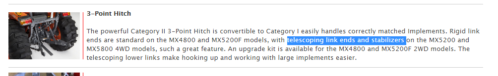

   / What will it pull #32
The telescoping links and stabilizers are nice, if you run alot of old equipment that aint QH compatible. Or have made alot of "homemade" stuff as I have, before even knowing what QH or QH compatible was.
And some of my stuff now, with having the MX, is cat I and some is cat II. So a QH just isnt something that would work for me. On my old L3400, I made something similar to carters/pats that only go on the lower links. And that was a lifesaver. The telescoping arms are equally as easy IMO.
My only complaint is the telescoping stabilizers. Hole selection is limited, and I can usually get to about a few inches of sway at the tail of an implement, which is good for most things. But I probably put 85-90% of my hours on with a 1600# mower back there. and being unable to take ALL the slop out, I go through alot of lynch pins.
I think, as a winter project, I am gonna look into modifying the stabilizers and maybe put a small turn-buckle on the end of each one. Just something with ~1" of travel would be fine. Get it as tight as I can with the pins, then use the turnbuckle to take the last bit of play out.
   / What will it pull #33
My only complaint is the PINNED stabilizers.
Lower Links telescope, not stabilizers.
kubota referes to them as telescopic stabilizers. Just using the OEM lingo
