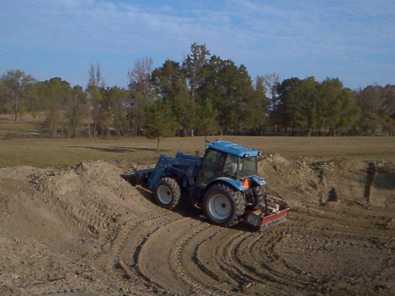

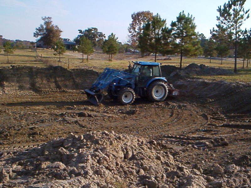

Correct in all accounts, plus I had the 6800# weight of my tractor to force the FEL to dig without a tooth bar. I find that on small CUT tractors, it is almost impossible to dig into hard ground without a tooth bar as regardless of the angle, it just skips along on the grass. By using the box blade scarifiers to loosen up the soil and drag a big load behind me, I pulled a lot more dirt toward the dam than I could just scooping it with the FEL. I had some practice doing that with my old Yanmar when I cut down a hill and leveled it out for my shop. It takes a bit of coordination to work all the levers at the same time but well worth the effort. When building the pond, I still had to use the FEL to push up the stuff the box blade drug up but that was accomplished in the next pass. It was always enough loose stuff to fill my FEL even after dragging all the box blade would hold.
Photos #1 is pushing up the loose dirt to make the lower dam. Photo #2 is backdragging the loose stuff in the bottom when I started to hit shale rock. It was much easier to gather it to one spot by back dragging than going forward and hitting a rock that would stall the tractor. After piling up the dirt to a height above what I needed, I ran the top using both the FEL and dragging the box blade to level off the top and make it wider. That was pretty scary in the first couple of passes as the dam wasn't as wide as my tractor so I had to use the steering brakes to keep it centered on top

Also in the second photo you can see the topsoil spoil pile to the right next to the pine trees. This was all the grass and roots that was removed and used on the back side of the dam. If I had put it in the dam, it would surely have leaked
