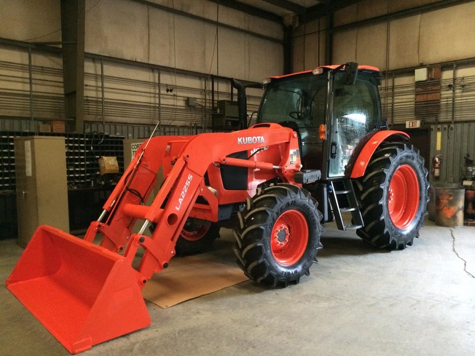

Oh, here is one of the largest CUTs on the market. Loaded rears and around 1,000 pounds pinned to the 3pt hitch.
Yea, the L6060 isn't as heavy as some of the others on the market but Ted beats the ever living crap out of it like it's nobody's business!
We'll see if the next tractor will bounce like that.

Is that an m6 or m7?
