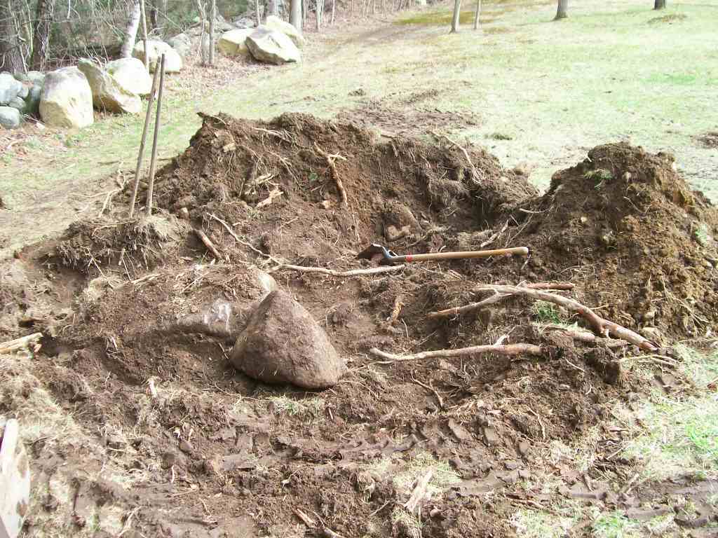

The 2305 will lift a loader full of dirt, mulch, and just about any other common material. It won't pick up boulders, but is available with the same size buckets as the 2320. The backhoe, and loader on the 2320 is a little stronger, and you gain position control, steering brakes, ground clearance, etc. but those things might not be critical to your operation. I was looking at both today casually, and it seems the 2320 is a bit more stable platform because of loader width to tractor width /height ratio. I think you would be disappointed in mowing with a 2320 after using your ZTR. You certainly can buy a 2320 without a backhoe cheaper than you can buy a 2305 with one.
   / What would you do: JD 2305, 2320, or Terramite T5C #4
"The 2305 will lift a loader full of dirt, mulch, and just about any other common material. It won't pick up boulders"
um, I've seen first hand a 2305 pick up a darned big rock/boulder what ever you want to call it, it was probably 600 or more pounds.
   / What would you do: JD 2305, 2320, or Terramite T5C #5
I agree JiminGa. It will pick up rocks like in the first photo, but perhaps not rocks like in the second one. I guess what I meant is that there are rocks that will fit in the loader that it won't/shouldn't lift. The rocks in the first photo were dug out, and piled there with my BX. The larger rocks against the stone wall were dug out with my BX, but I had to push/roll them against the wall since I couldn't lift them. You can air up the front tires, slide the bucket under rocks like that, curl just a bit, chain them to the bucket, and pull them using the bucket for a sled.
